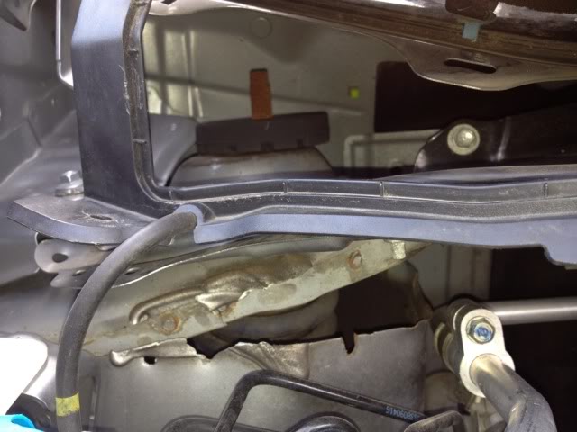

Interesting. That piece, the front damper housing, is rated with a tensile strength of 270 MPa or 39160.1891871 psi. That is NOT one of the high tensile strength pieces of the uni-body. Still, could be a bad weld, it's not impossible.
As far as the manual is concerned, those welds don't exist. Those welds are a part of the larger front damper housing piece which the manual does not break down into it's component welds. Odds are those welds and the whole damper housing are made prior to the frame being assembled on the line.

Made my day. Adapt and overcome. Still, even I would be shitting bricks in this situation. I can't think of any humanly possible way to correctly repair that to oem without completely removing the whole damper assembly. The least this will set you back diy is:
001 014 60650-TK6-A00ZZ View HOUSING, R. FR. SHOCK ABSORBER $132.33

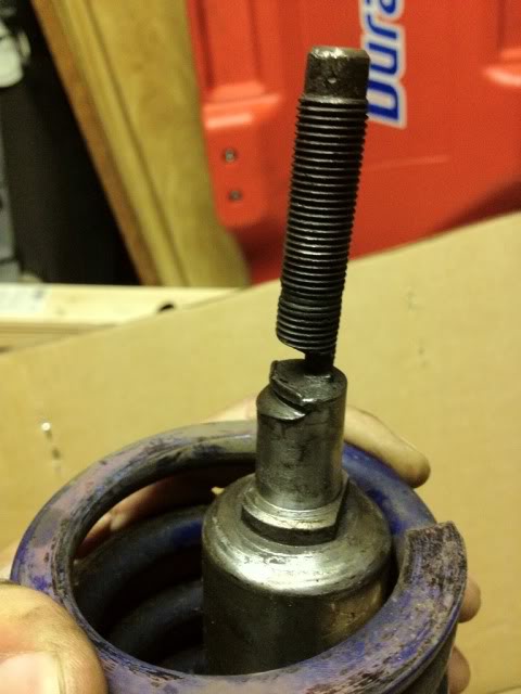

Well heres an update for those who wanted.
My car is out of warranty and is not covered by Honda and they saw all the signs that the car had different suspension.
This damage was not caused by having coilovers or having wide wheels it's came from hitting potholes and the damage became worse over time, probably starting by breaking a spot weld if I hit a bad pothole and So on until it got how it is now . They squeaking sound that I herd was the metal eating away at the coilover from it being shifted after an impact
Now the car is just sitting . I'm waiting for some time to get into a friends shop so I can remove the suspension align all the metal back together and weld it completely around instead of cheap ass tack welds and I will doing the same to the otherside as well
