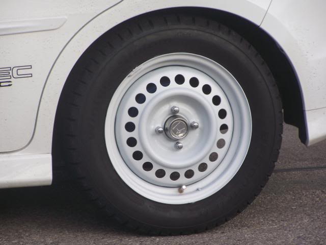

I am on 15's for the Winter. Tire size is
185/65R15 BFG Winter Slalom

1. Black3sr, your car looks sweet with that set-up. I stole the center cap from you I think.
