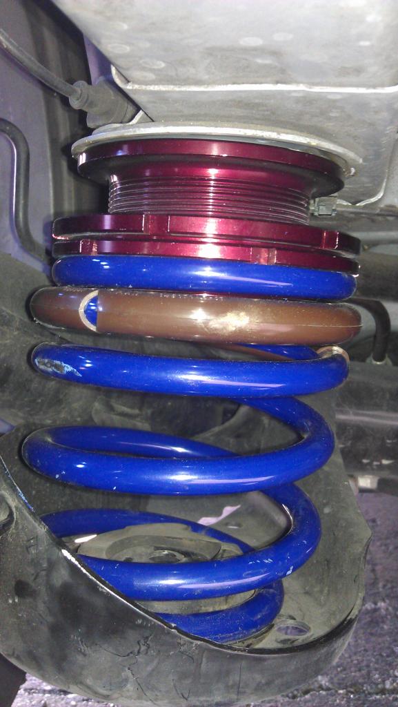

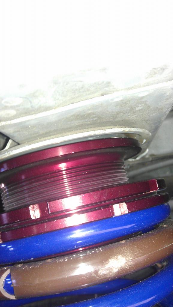

hi so i install my buddy clubs and im having issues wiht my rear its make noises did i install it wrong i know for sure i put the bottom bushing for the coil but top did not fit.... mkaeing like a pop when im going up drive ways its not my strut they dnt move all noise coming from coil i have 50 miles on them so far there brand new!! here is a pic of my coil for the rear plz any OP im willing to try and im not even slam 2 finger gap front and 1 1/2 rear

The noise comes from the rear shock being adjusted too long, whats happening is the shock is hyper extending past the spring travel range allowing the spring to "unload itself" and pop. What you can do is shorten the shock length with the coil collar on the shock (some lower end coil-overs don't allow this like Tein Basis because it has a fixed length etc) I'm not sure if the Buddy Club lets you adjust shock body length.

Also for some reason your springs look like its installed upside down, you can see that the spring seems to be scuffing the lower spring pocket. Did you make sure the rubber lower seat insulator is put back in? It looks missing.

Yeah, be sure the spring is seated properly against the lower rubber piece. You need to install the top one as well, all the noise issues I had disappeared once I put it back on.
This is the same thing I was thinking when I looked at pics.

its not upside down its my spring load all fuk up story short thank u all of u for ur help i thank u guys so much im having buddy club them fix it <3 tomorrow morning im so fuken bum out

rubber insulator whats that i knw the tops missing
Well... at least you figured it out bro.

I was going to attached this DIY with pictures its is a Civic similar setup they make a point on the top rubber insulator but could not tell from your pictures if you had it installed.
DIY - DIY: 8thgen coilovers Installed on 9thgen Civic SI - ***Warning picture heavy | 9th Generation Honda Civic Forum

yea mines not on there the shop who installed did not put it thansk so much u guys i talk to a friend at buddy club he offer me tomorrow he said he knw whats wrong so hope all goes well all said probly ur shock to long liek u guys said

I never put that rubber piece on. No noise. The top piece that is.
