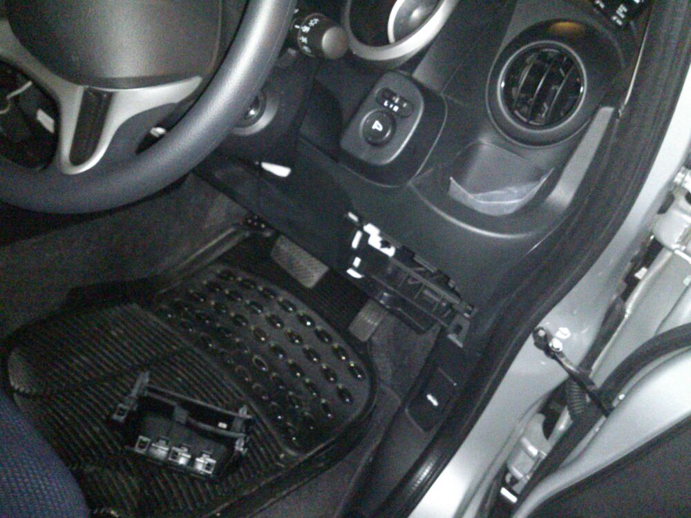

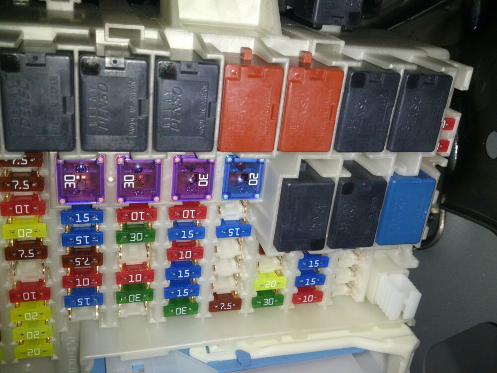

Any one know which is the turn singal light relay?
hi, everyone. i am coming from hong kong, sorry for my bad english
i want to switch my relay to some led relay(make it dont flash too fast)
but i cant find which is the exactly relay is
please help me
here is some relay i found, my friend told me not to unplug any one of those, because some are computer.that will makes it locked the computer and can't fire up again unless "killed the code"

None of those. The flasher is built into the instrument gauge cluster; you need to take the dashboard pretty much completely apart to get to it. It's much, much easier to put in load resistors.
Here's a thread with details: https://www.fitfreak.net/forums/fit-...l-flasher.html
