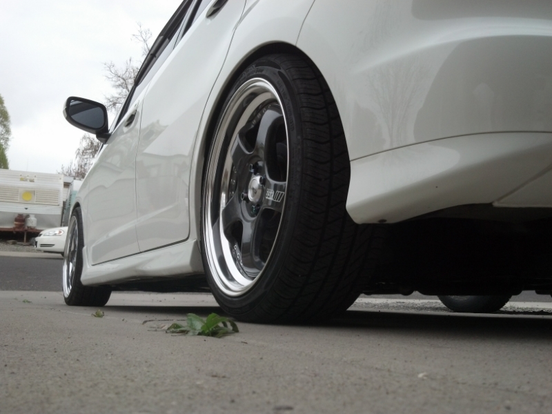

I'm running 17x7.5 +43 and a 5mm spacer in back and 3mm in front. Effectively +40 fronts and +38 rear. I barely had to roll the rears to quit the rubbing.
