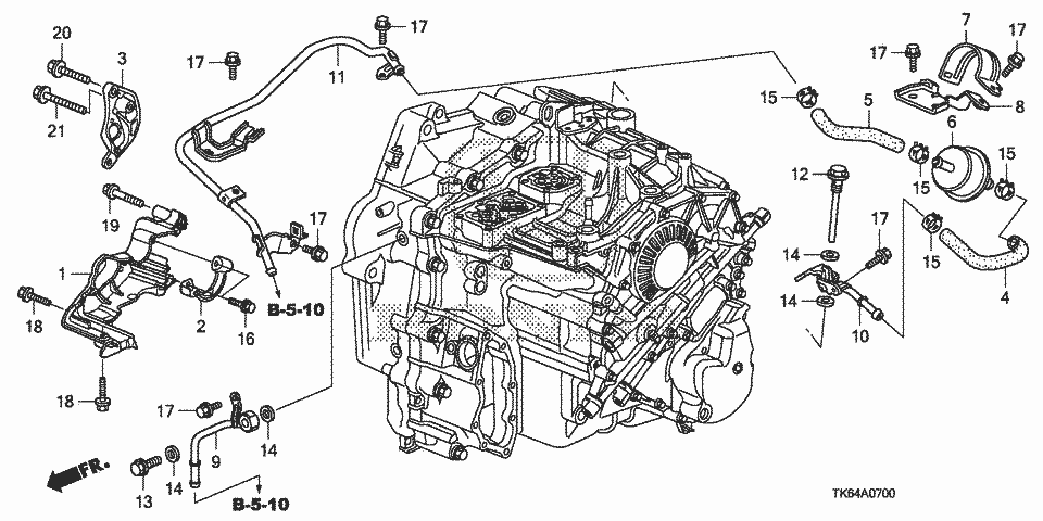

Anybody that sells Honda parts online has the diagrams. This is from hondaautomotiveparts.com. It's not very clear though. I believe the fluid goes from the tranny, through the filter and then to the radiator. Maybe others can confirm this.
GE Fit automatic
Someone once posted an interesting method to change ALL the fluid. See post #18. Haven't tried it though, maybe next time I do mine.
