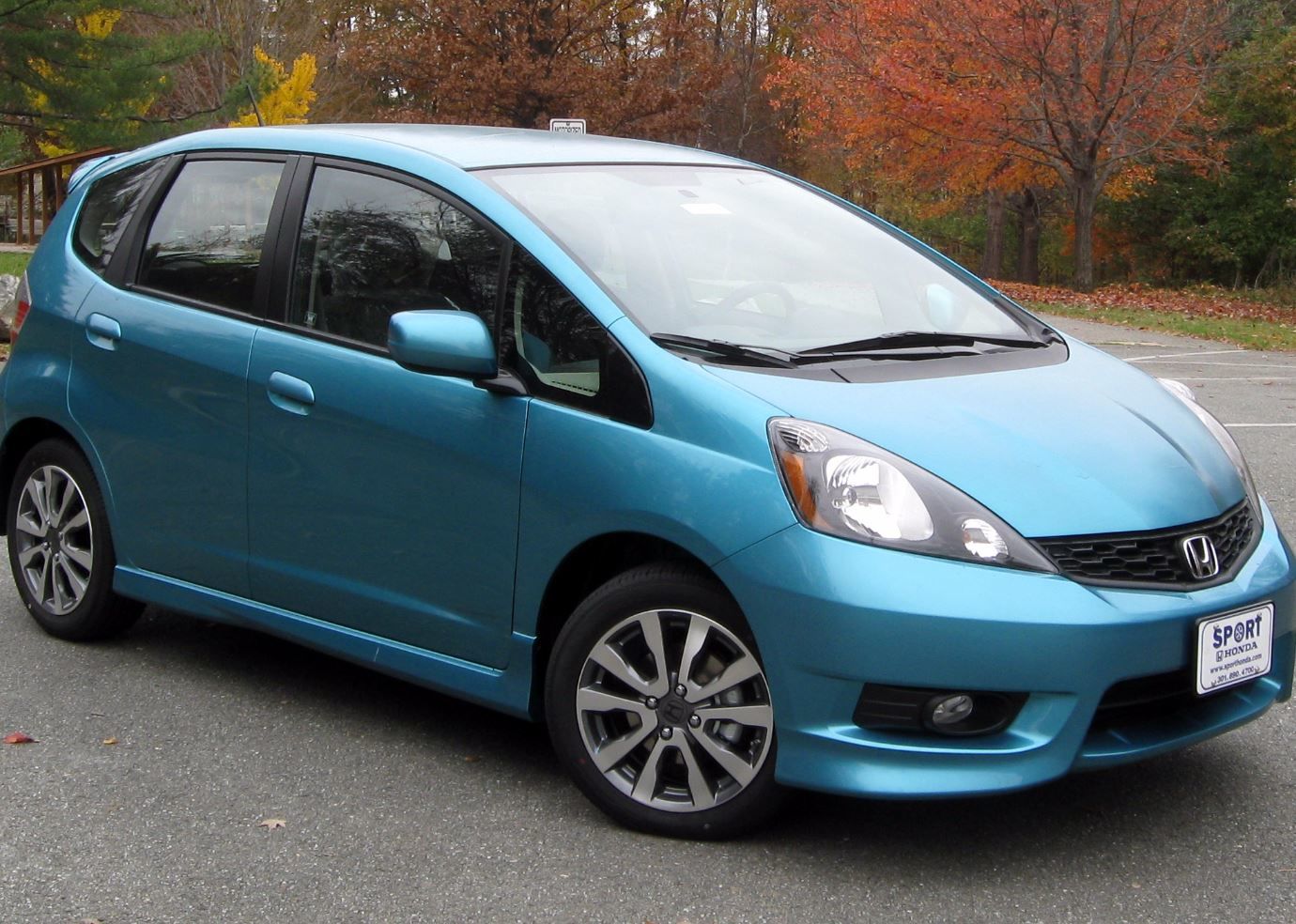

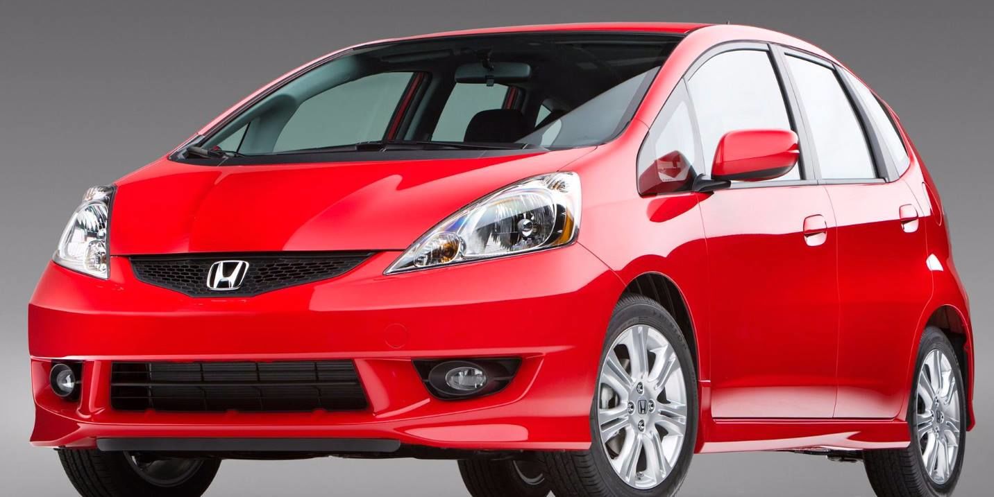

From my knowledge there was a face life from 09-11 to 12-13.
Here is the 09-11 sport
If you take a look at the sport there is space between the headlights and grill
But in 12-13 ( this color was only produced these years btw) there is no more space and the grill has changed.. the 9-11 sport looks like it has the base grill in 12-13 now imo i havent checked
I am in a base currently and planning on going to the sport front end so ive been doing my research. I do know the fenders are the same but im still checking on if the headlights are the same. The only difference i know the 12-13 base to sport change for sure is, is that the housing is black in the sport.
