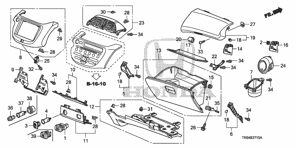

For 09 and 10 I found "JACK ASSY., AUX IN.", Honda part # 39112-TA0-003
Item #1 in this diagram
Catalog link: Honda Automotive Parts
Hi All! New guy here with a question... follow on ...to the above (OP) question.
This is a great graphic for the FIT with navigation, but can anyone provide a graphic for the version without the navigation system? I guess it's referenced as B-16-10 in the above graphic, but I don't know how I would get access to that. I did find a great YouTube video on how to pull out the Audio system for this version of the fit dashboard in case anyone else could benefit from it. Looks like it might be an easy replacement after that point, but wondering if anyone else who has dealt with it might have any useful advice on where to buy a replacement? Or maybe I just need to bend/clean the clips a bit? Did something like that with an old guitar once and it seemed to do the trick.

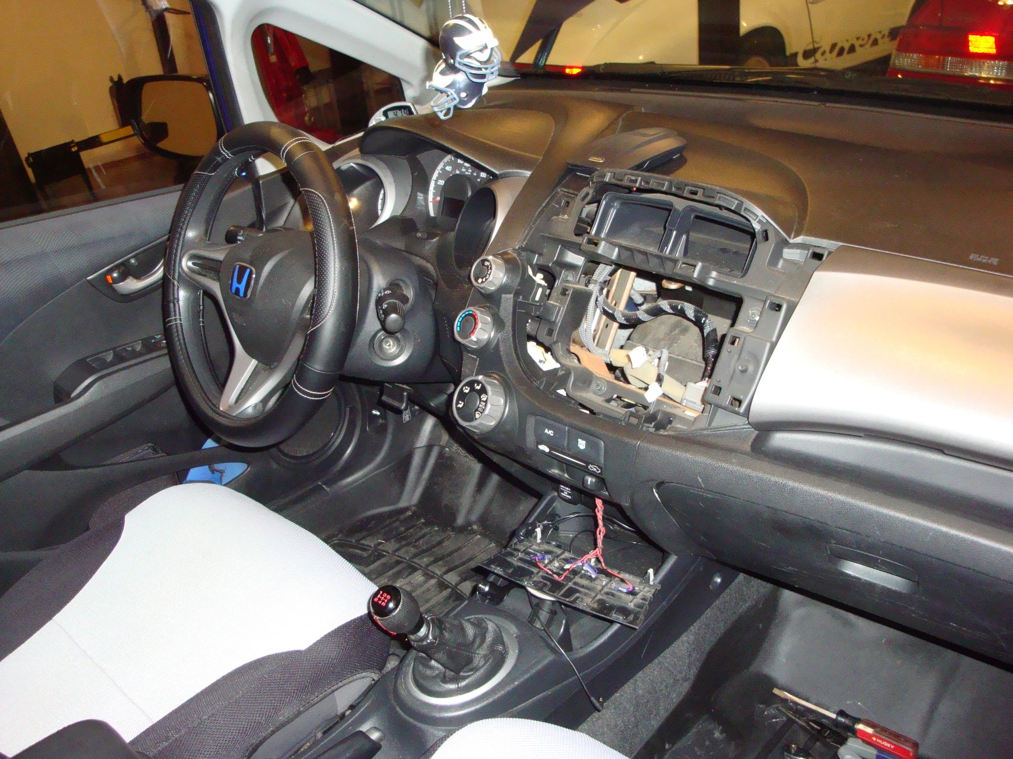

Here's a couple pics of my 2010 that I swapped my oem stereo for an Alpine from Crutchfield. It was super-easy...even for someone like me that had never done it before.
Also the Alpine unit has a front panel aux out jack.
