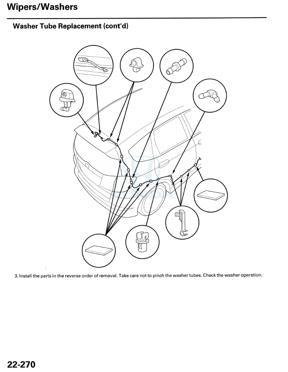

I have a 2010 Sport and all the Nozzles stopped working, not at the same time. First the front ones went, they were gummed up. Then the rear stopped working and I was told there is a one way valve to the rear washer that was gummed up. I went to my usual mechanic and was told that they had seen this before with RainX especially if it mixes with other brand Washing fluid. I replaced the nozzle which didn't help. I was told I should go to a collision repair place because the liner would need to be removed and I was quoted over a thousand dollars for the repair. I went to my Honda dealer and they found the problem at the one way valve and repaired for under $200. Hard lesson learned. Don't use RainX. Hope this helps someone.
Old Jan 21, 2025 | 09:50 PM
Drew21's Avatar
Joined: Oct 2020
Posts: 890
From: MA
I also have a 2010 Fit Sport. The line to the rear washer runs through the firewall in the passenger footwell and then backwards along the floor next to the side sill before climbing up the rear passenger wheel well towards the right rear corner of the cabin where it goes through a rubber hose into the rear hatch.
If you want to access the hose in the main part of the cabin you don't need to touch the ceiling liner, you need to remove trim pieces along the floor and fold the carpet back a bit. Similarly, in the rear hatch area there are two big trim pieces covering the wheel well and window surround along with some smaller pieces surrounding the rear hatch opening. The washer hose runs under the ceiling liner right before transitioning into the rear hatch, but only for a few inches.
Whoever told you this is a $1000 job either doesn't know what they're talking about or is trying to take you for a ride.
