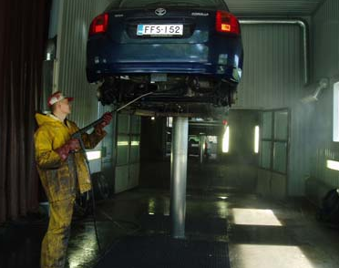

I'll have to chat with my friend, how did rusptoofing to the car in his previous job. Something like that:
