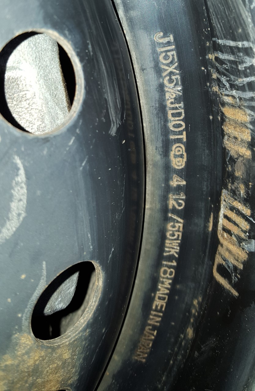

The number on the rim is:
J 15x5 1/2 JDOT (4 12 / 55 WK 18 MADE IN JAPAN)
So I know it is 15 inch diameter, 5 1/2 inches wide, 4 bolts

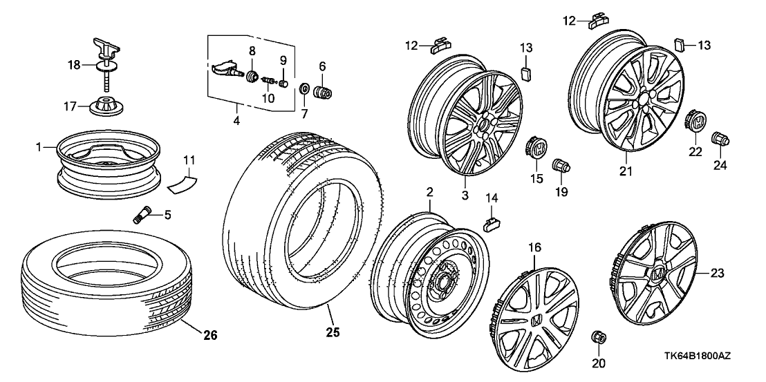

I believe the part number is 42700-TK6-A01 based on the Honda Parts Now web site.

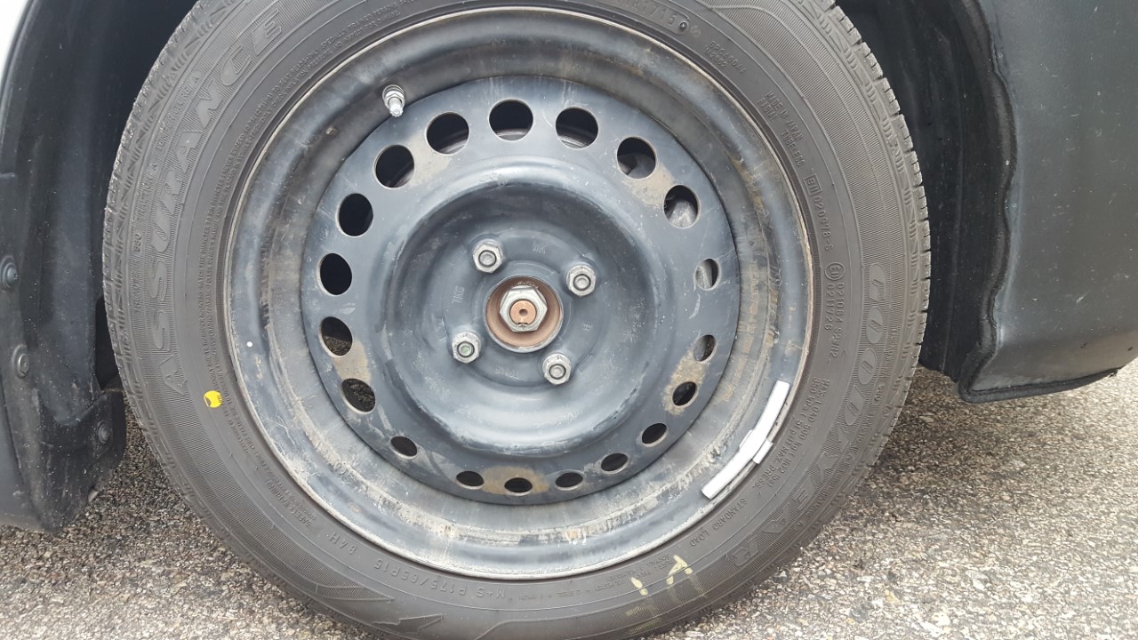

Any suggestions where to get a rim for my Fit? I don't want to replace all 4 with a new size.

Do you want to stay with a stock steel wheel? If so, Rockauto.com has it shipped for a little over $80.
If you want to go with something a bit more stylish i think the Civics from the early 2000's are a direct bolt-on.

Yes, I'm just looking for stock wheels as I only need to replace one bent rim.

You are looking for 15x5.5 +55 and the bolt pattern is 4x100. If you're simply trying to replace the steel wheel I'd call your local junk yard/auto wreckers. Or even check craigslist. Maybe someone with a base fit upgraded to an aftermarket wheel.
