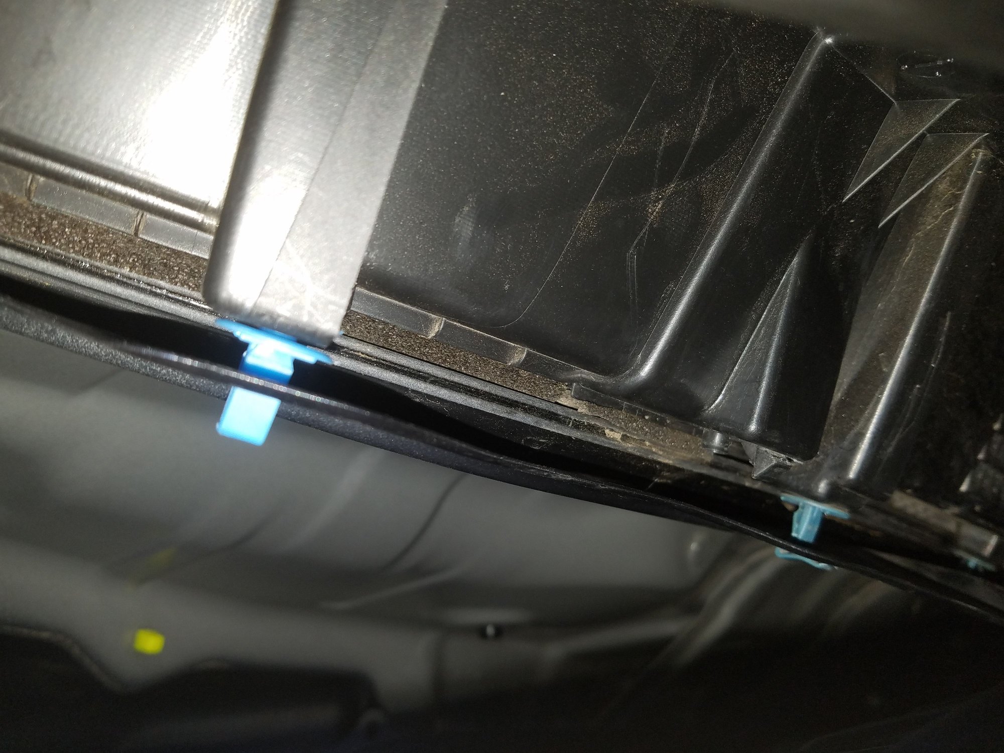

Cowl not installed correctly
Got the car this afternoon and the engine sound is way better now. They said valve #3 is too loose.
But now the cowl is loose and they didn't put it back properly. I hate it that everytime they touch it they mess up something on the car.
Cowl is not flush against the windshield and i can lift the part of the cowl on the passenger side. I tried to push it down but looks like the fasteners are broken so it doesn't lock up.
This is on the passenger side. Is this suppose to be like this? Or there should be no space between them like the one on the driver side?

As you can see the gap (between the two cowling pieces / front edge) is normal (your #3 pic) as Black3sr notes, but.......
The end cowling piece (hook up the side of the windshield) is not installed properly. From my own personal "bad" experience, there is a plastic push-pin that you should be able to check by opening the hood (right under the corner of hood). When they pop or when you drop, they fall into the abyss and you need a new one. The dealer didn't have in stock and they are about $3 if I remember correctly (?).
As you can see from my pic, the cowling should be tight against the A-pillar but your's is not.

I was able to fix the end part of the cowl but the main cowl from the middle up to the passenger side is not fastened. I can lift it up. Should I go back to the dealer and have them fix this?

The service guy fixed the cowl but when I got home, those clips or fasteners pop back out. I tried to push it back but no success.
Its #27 from the diagram.
Genuine Honda OEM Automotive Parts Catalog - Bernardi Parts
Last edited by utsug; Nov 17, 2017 at 01:49 AM. Reason: Found it....#27 from the diagram
