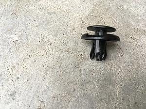

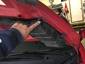

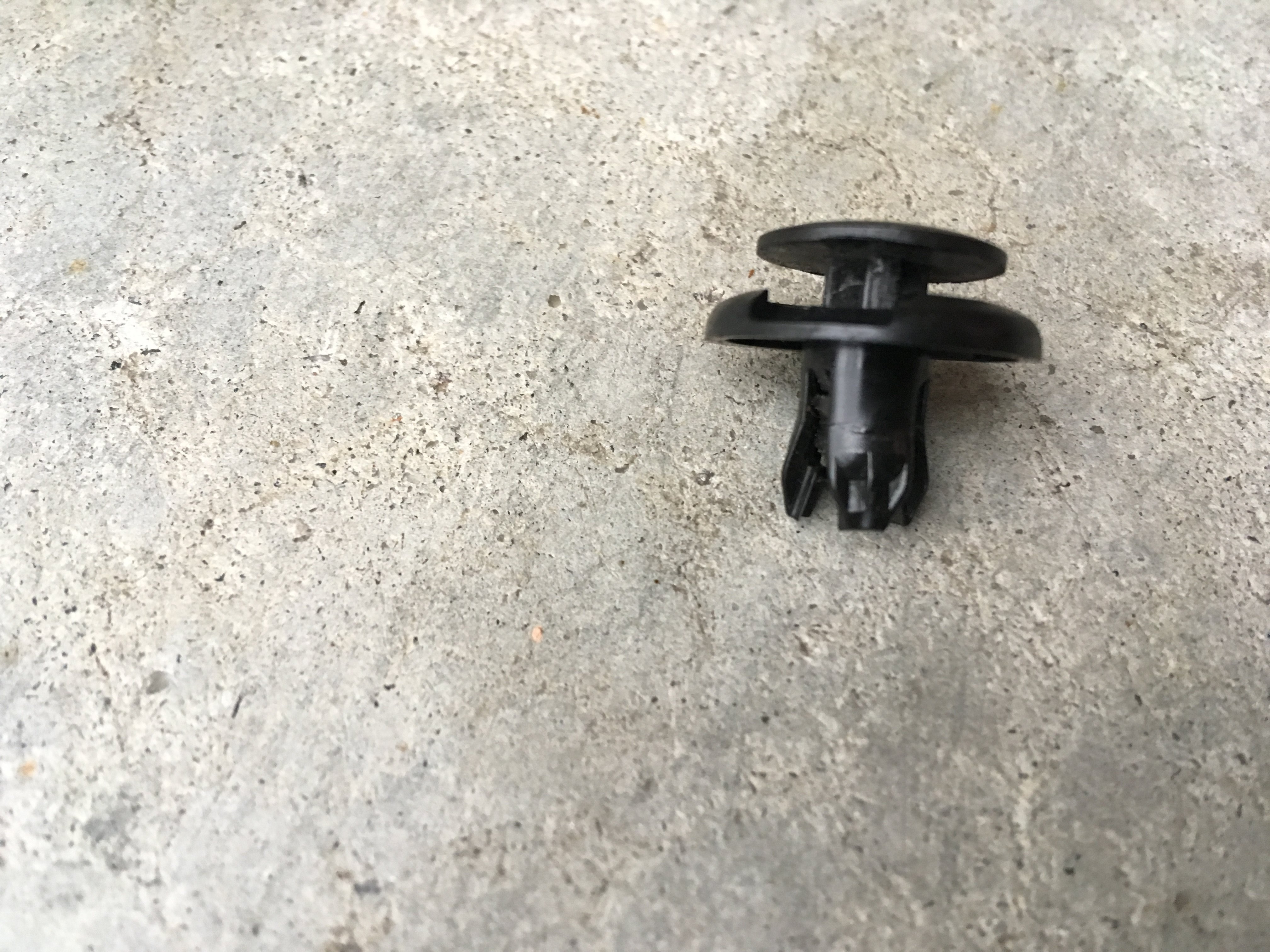

I have a series of small, black fasteners that seem to be disappearing on my 2012 FIT. They are these little parts (see pictures attached) that are holding the trim, that directs air from the grill to the engine bay. When you lift the hood, this big rubber piece is on the right.
I bet I could save a little time and cash if I had a part number and could order them on the web, versus going to a dealer.
Anyone have an idea on part number?

I don't have a part number for you, but here's what I ordered...
Amazon Amazon
There are lots of other options on Amazon besides those, but I can say the ones I got are very similar to OEM quality.
With the big bag in my inventory, I now yank them out without hesitation and pitch them in the trash. Also went through and replaced all that were easy to get to just to have new clean ones.

91512-R21-013 is the part number for those clips

It is called a rubber thing. Anyhow the clips. Push around the outside of the clip to insert it. Then push down on the center to expand it and keep from coming out.

The clip size you need is the 8mm diameter ones. Mine came in variety box of different sizes. In the box, I got both the type that allows you to pop it loose again easily, and the other type that locks tight in place and you end up breaking it when trying to remove it.
