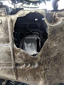

So it all started with me being stupid. 2011 Fit with 65,000 miles. I was just doing an oil change, which I've done a bunch of times before. Normally I jack it up from the side, but that doesn't really work the best and I wanted to try something different, I figured I would try from the center this time from what I thought was labelled as a jack point... I was dumb and I jacked it up by the oil pan, which quickly ended with the jack penetrating said oil pan.

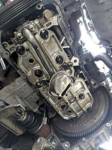

I was pretty sure it was the oil pickup, since it was pushed up slightly when the jack smashed into it.

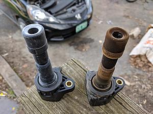

So I replaced the battery (kind of needed it anyways), spark plugs, and coils. One of the coils looked pretty brown and smelled like oil, so I'm thinking there was a loose plug.

The pick up looks to be pushed to one side. I wonder if there is a leak where it is attached and it is sucking air?
