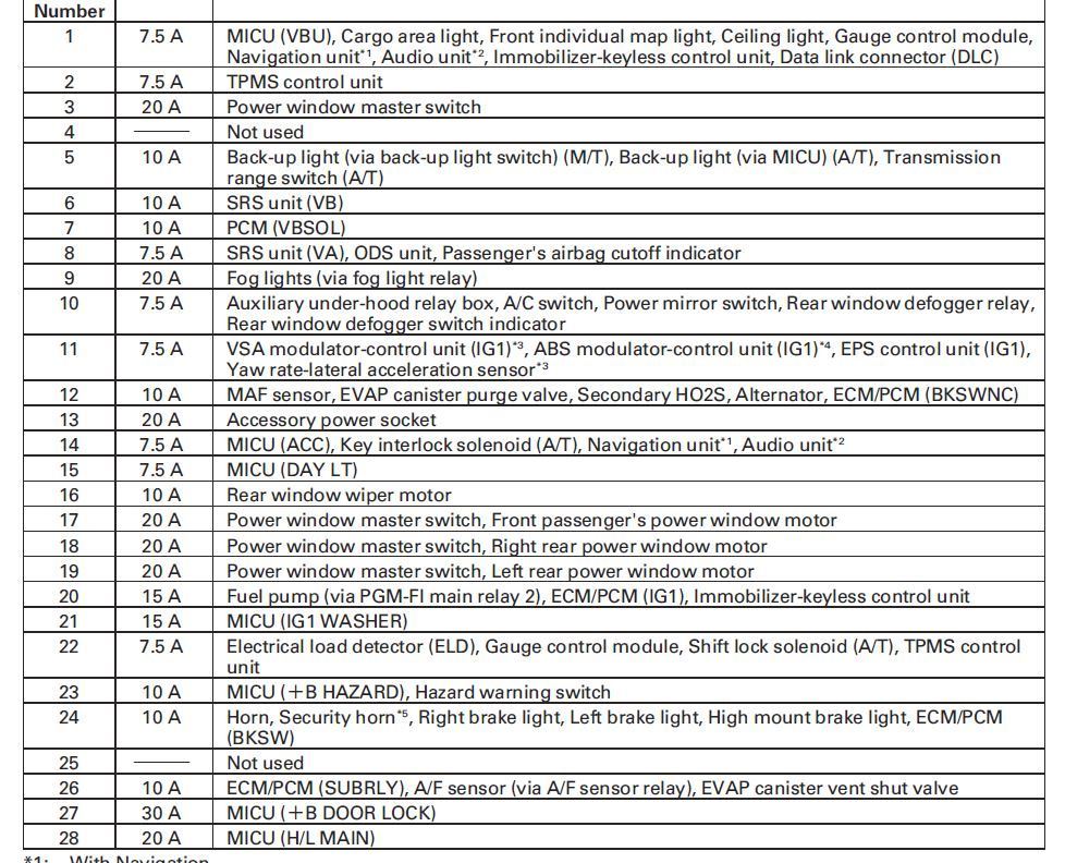

Hi guys,
So I’m onto my second Jazz. I traded in my base model for a vti (sports in USA).
Since I got the car on the weekend, the dealers are closed and can’t get back to me till Monday.
Nontheless, thought I would do a little research of my own.
The issue is, when I use keyless entry to lock/unlock, it sounds like it’s only unlocking the hatch and not the doors. When I use the keyhole to unlock it, it then now unlocks the driver side and the hatch but not the other doors.
Inside the car, when I use the locking button in my window control, again, only unlocks/locks the hatch.
Could these be a fuse problem or something else?

Could be fuses. Here is a list,-

Thanks for the fuse list!!
Looking at that list, I don't think it's the fuses.
When I use the button from my key, it only unlocks the trunk and nothing else. Same goes with me pressing the central locking in my window controls, only locks the boot.

Maybe it is the main bits in the drivers door. There should be other threads on here about similar problems. I believe that unit in the door is rather pricey to replace.
