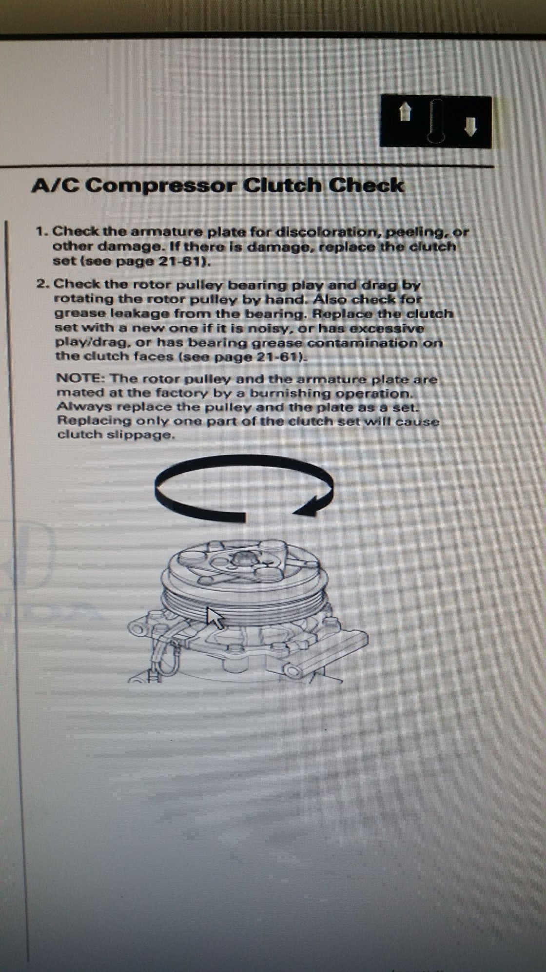

Glad to hear the plugs are showing right. If we're moving on to thinking its the compressor, theres some more stuff to test! I imagine the A/C compressor clutch could be a possibility. Perhaps when it kicks on? We could get some ideas if you could have a friend sit in the car and turn the ac on while you watch and listen to the compressor. If i recall correctly its on the vehicle front right side at the bottom. Kinda standard location. Try it with the car warmed up, cold, and have em press on the throttle while you watch that pulley wheel. I've got the service manual for the car so I'll check it out a little later and see what info I can pass on in regards to the system

Theres the troubleshooting procedures for the compressor clutch itself. I've got the whole book, so let me know if you want to pursue a specific direction from here.

Brought somethin else to mind. This likely wont help much, but I and my dealer found it interesting. My 12 fit had trouble with it's A/C system a year or two back (long forgotten.) The only symptom was the air not cooling despite the charge being good and the system untampered with. Followed honda's troubleshooting procedures and found no faults til checking ohms on the field coil. Came in at 4 instead of the recommended 3.something shown in the post above, last image. I popped the bad boy out n found it had a little hole melted into its face.
Stopped troubleshooting and got a new coil, which also ohmed in at 4, so that didn't fix it. A rat chewed through a wire hidden by the front right headlight. At any rate, if you or anyone find yourself testing the coil while going through the above procedure, expect mildly out of spec ohms from P/N 6LJ25L, and feel free to continue troubleshooting beyond it.
