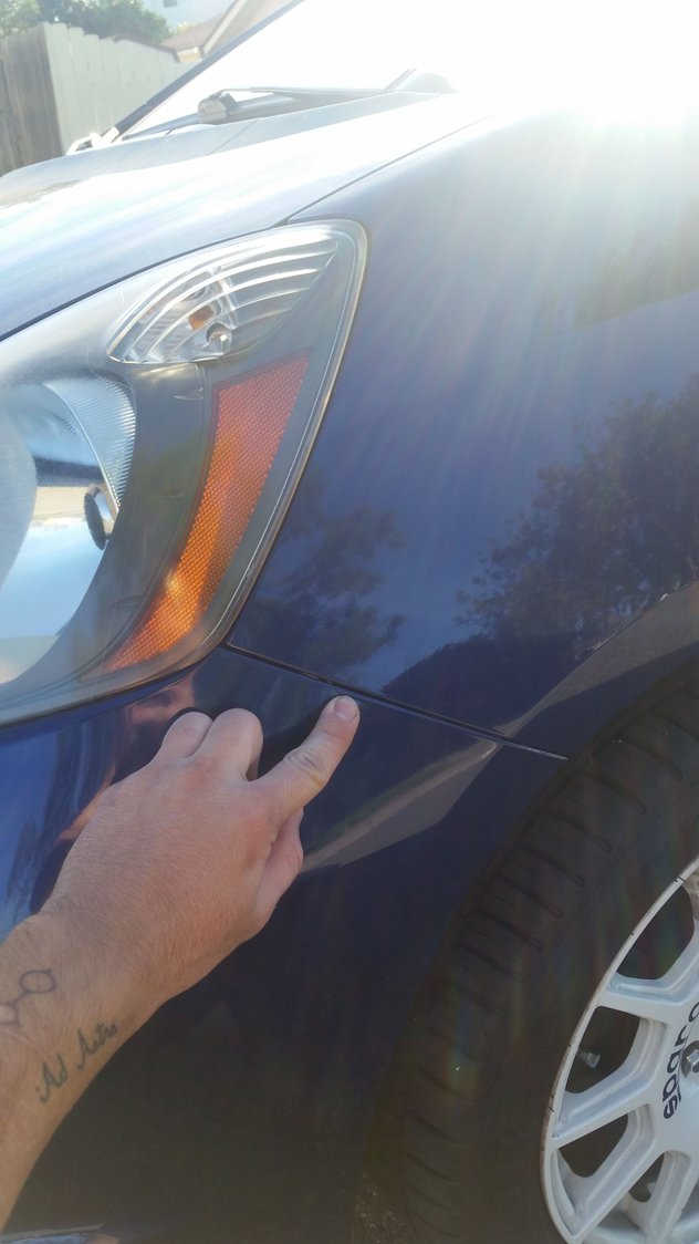

next one is a ticking coming from the front left, potentially engine bay. Well, it wasnt an electrical arc so I've gotta glue my hair back on. It was the front bumper, where it attatches just below the headlight and also meets the sizeable body panel that goes over the doors and to the rear. The bumper has some seriously stiff clippies there. when I removed the bumper to install a sheet of aluminum honeycomb mesh to sit behind the lower grill and protect the condenser, I busted a clip.
​​​​lesson learned. This time around I used trim tools to unclip and re-clip the bumper more carefully. I resolved the issue by cleaning off the surface where the offender would have clicked with rubbing alcohol, then applied some fancy fiberglass friction tape (the kind used to cover wire joints in ovens). Its sticky as can be, holds up forever, and its all I had to handle friction. Another mystery solved, gang. So for now I'm hangin up my ascot and feeling fine.
