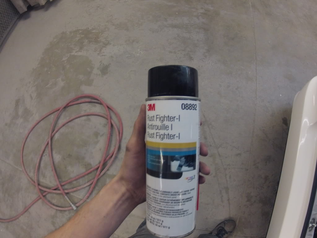

i used 3m rust fighter part number 8892

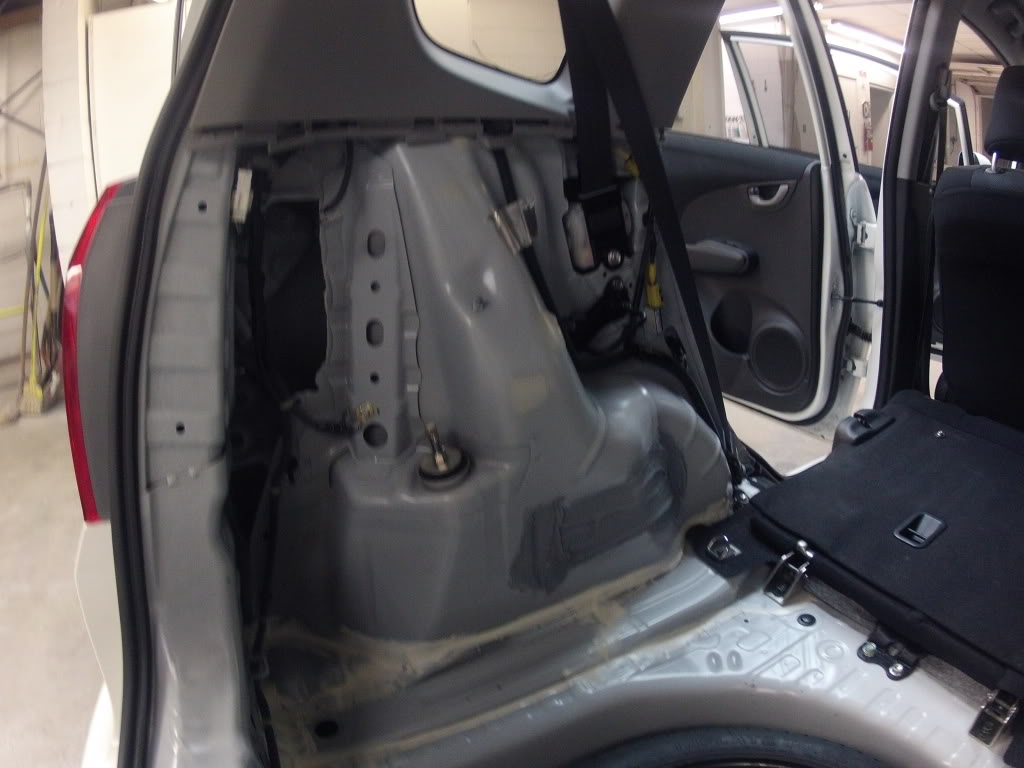

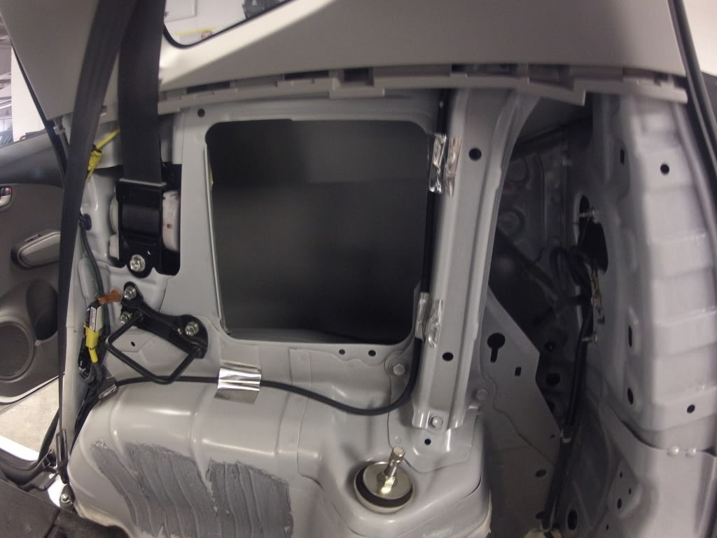

you have to remove a few interior panels but nothing too difficult really.
the driver's side is hard to access because of the fuel delivery but the passenger side is nice and open.
i used the full can for both sides. if you do this in a warm area, you can feel the outside of the quarter panel to check where the rust fighter is going (the metal will get colder where the material is being applied). also worth noting, the rust fighter will stink up your car for a bit.
i also applied a heavy bodied seam sealer around the lip of the wheel arch.
