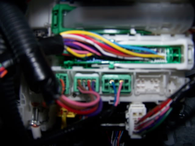

Hi people I own a 2009 Red Fit and I just installed a pair of headlights to make it cooler.
Unfortunately I wasnt able to disable the DRL and the headlights keep turning on every time and release my E-brake.
I heard pulling off the #15 fuse would disable the DRL
But I dont know how and which one to pull ><

When you've got your head down there looking at the fuse panel... look to the side, next to the door.

The OP's problem is, he doesn't know which one is #15.
Hence my comment about looking to the side. There's a fuse layout printed onto the panel.

For future reference, it's the 2nd column, 5th up from the bottom. The 7.5 amp... IIRC.

The Fuse your looking for is a dark Red one, and if i remember correctly stands alone. so #15, dark Red, stands alone, theres a photo floating around here somewhere that shows exactly which one.
