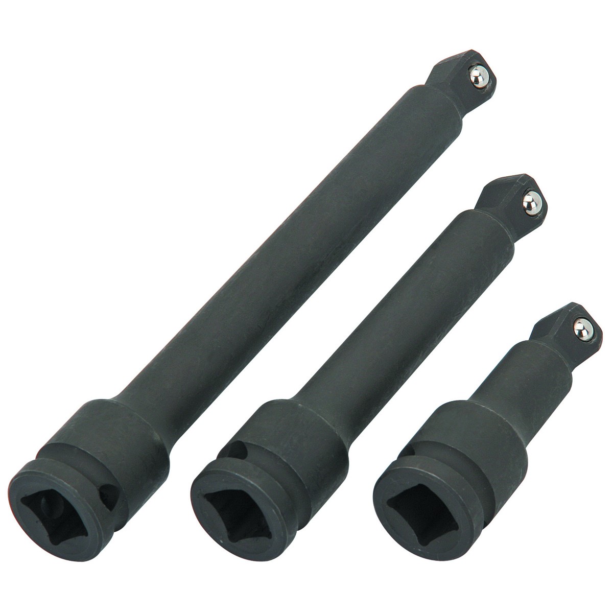

If your concern is that bottom pivot bolt, yeah you need wobble extensions for your ratchet to put any torque on it. Straight sets won't work.
You can get either impact type or regular.
3 Piece 1/2" Drive Impact Wobble Socket Extension Set
These are some of the most-used tools in my toolbox.

A friend of mine provided a diagram showing how to get at the lower bolt (I didn't realize that it went in the other direction from the upper bolt). Looks like I'll just need to shell out a few bucks for some of those, and I'll be good to go!

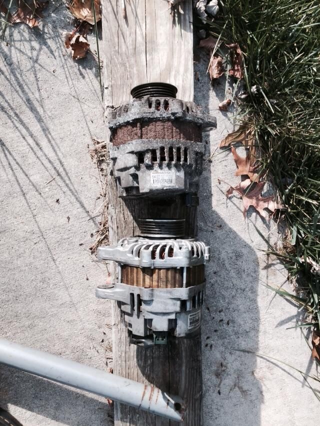

I managed to get the "new" alternator installed last Friday. I was a little scared that I'd damage an AC line, but I was able to squeeze the alternators by it without too much trouble. I didn't even need the wobble extensions! Though they did make it easier to remove the bolts once they started to back out, so I'm really glad I got them.
I still have to get a belt for it. I'll probably pick one up at Advance Auto sometime this week (30% off coupons for online orders are almost always available, and picking up in the store results in no shipping costs... makes most things very affordable!)
I'm going to have to flip through my manual to see if there's a diagram and instructions for working the tensioner.
Thanks for all the help, everyone!
Here's the two alternators side by side:

How much did the restored alternator cost?
Did you have to hand in the old one?
Old Dec 4, 2015 | 07:52 AM
deevergote's Avatar
Joined: May 2012
Posts: 48
From: NJ
It wasn't restored, just used. I believe it was a junkyard part. It must've had few miles on it, though, because it looked quite good!
I got it on eBay for $35 shipped. In fact, the seller just emailed me this morning reminding me to leave feedback (which I'm holding off on doing until I install a belt... gotta make sure it works before I say I'm happy with it!)
