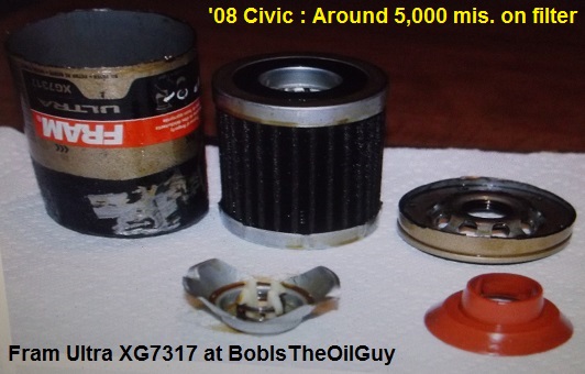

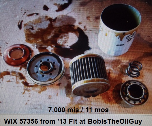

Thanks , that's where I discovered the oil filters . There are many pics of oil filters opened new and used . I was looking at a Ultra XG 7317 yesterday . Forgot to mention the WIX 57356 that was just posted at BobIsTheOilGuy used for a '13 FIT . That looks sturdy . Might alternate brands . Here's post for it , Wix 57356 cut open - approx. 7k miles | Engine Oil Filters | Bob Is The Oil Guy .

WIX is the one that builds MOST of the top rated filters for other brands.. FWIW

Here's pictures of the FRAM Ultra XG7317 and WIX 57356 from BobIsTheOilGuy . More at their site . v Click to enlarge v .
Attached Thumbnails Oil filters : Anyone using / used one or more of these ? NAPA Gold 7356 ,-dscf6736.jpg   Oil filters : Anyone using / used one or more of these ? NAPA Gold 7356 ,-dscf6727.jpg

May have to flip a oil drain crush washer to help decide . Both look well made .

I used to buy Fram filters till I started to get into the details of what makes a filter great.
The Napa Gold filter is my top pic. Part for part this thing is far better quality than anything that Fram offers. Thicker casing, silicone drain back valve, coil spring compression, spiral cores and a better filter media.
Fram's Extra and Tough guard have a lot of short cuts. Thin casings, stamped steel compression, fiber board media ends, uneven pleats that are glued poorly together, and sometimes plastic cores. They built their rep on tradition but they have become a value oriented product, hence the compromises in construction.

NAPA gold filters are made by Wix. NAPA even uses the same Wix part numbers with the leading digit of the Wix number usually deleted. Wix has a good reputation and makes a good filer. I buy Wix filters by the case for each vehicle I own. NAPA is a good alternative if you only want one and want to get it locally.

The Fram Ultra filter is the best bang for the buck on the market. The XG7317 can be had from Amazon for ~$7 when you subscribe to it.
It is probably the only filter I would run two oil changes on, as called out by the MM.
There are two recent cut ups on BITOG showing the base model PH7317 Fram extended guard held up great for over 9,000 miles on a Civic and a Fit.
