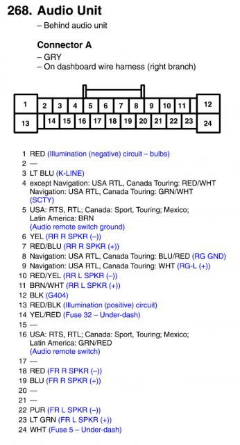

Rather than tap into the factory harness, I bought 2 Metra 70-1729 harnesses and stole a couple pins from one to add the control switch and control ground to the other harness. Insert one pin at postion 5 and one at position 16.
Here is a pinout for the 24 pin connector - ignore fuse references, etc. Pin 5 and Pin 16 are the ones you care about. To orient correctly, Pins 1 and 13 are the Illumination/Dimmer orange and orange/white wires in a Metra harness. Pin 12 is Gnd (Black) and 24 is 12v.
