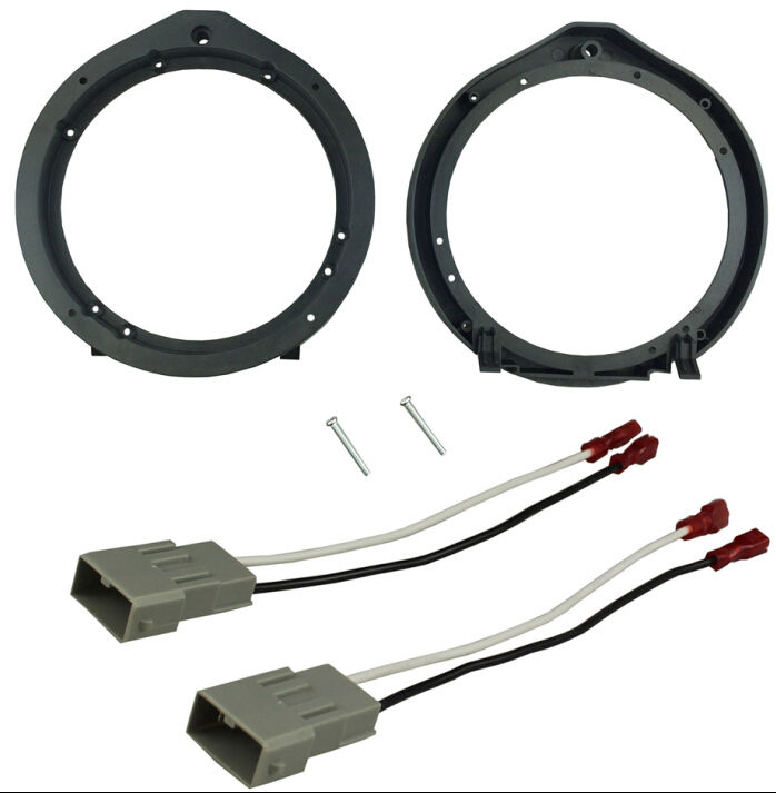

Do you think that these adapter rings would be a direct fit to 2012 Jazz/Fit? As your aliexpress link is not working anymore
For Honda Civic 2001-06 Speaker Adaptor Rings 6.5"/6.75" with Wire Cable Adaptor | eBay

This was a perfetct fit
