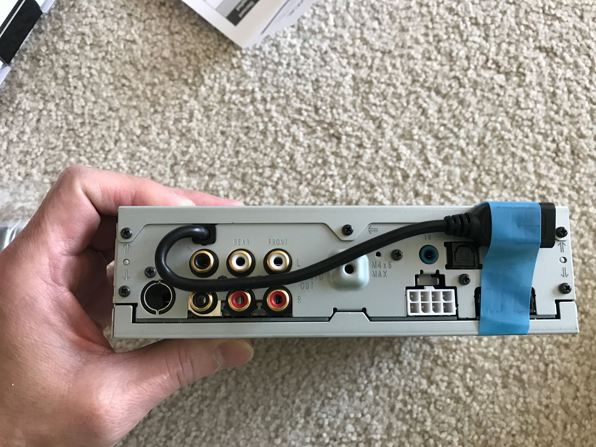

now here is the unboxing pictures of the Sony RSX-GS9

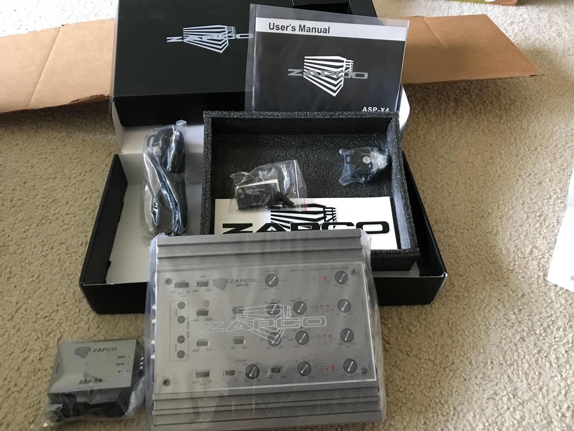

Zapco ASP-X4 Electronic Crossover arrives today
Beautiful Finish :

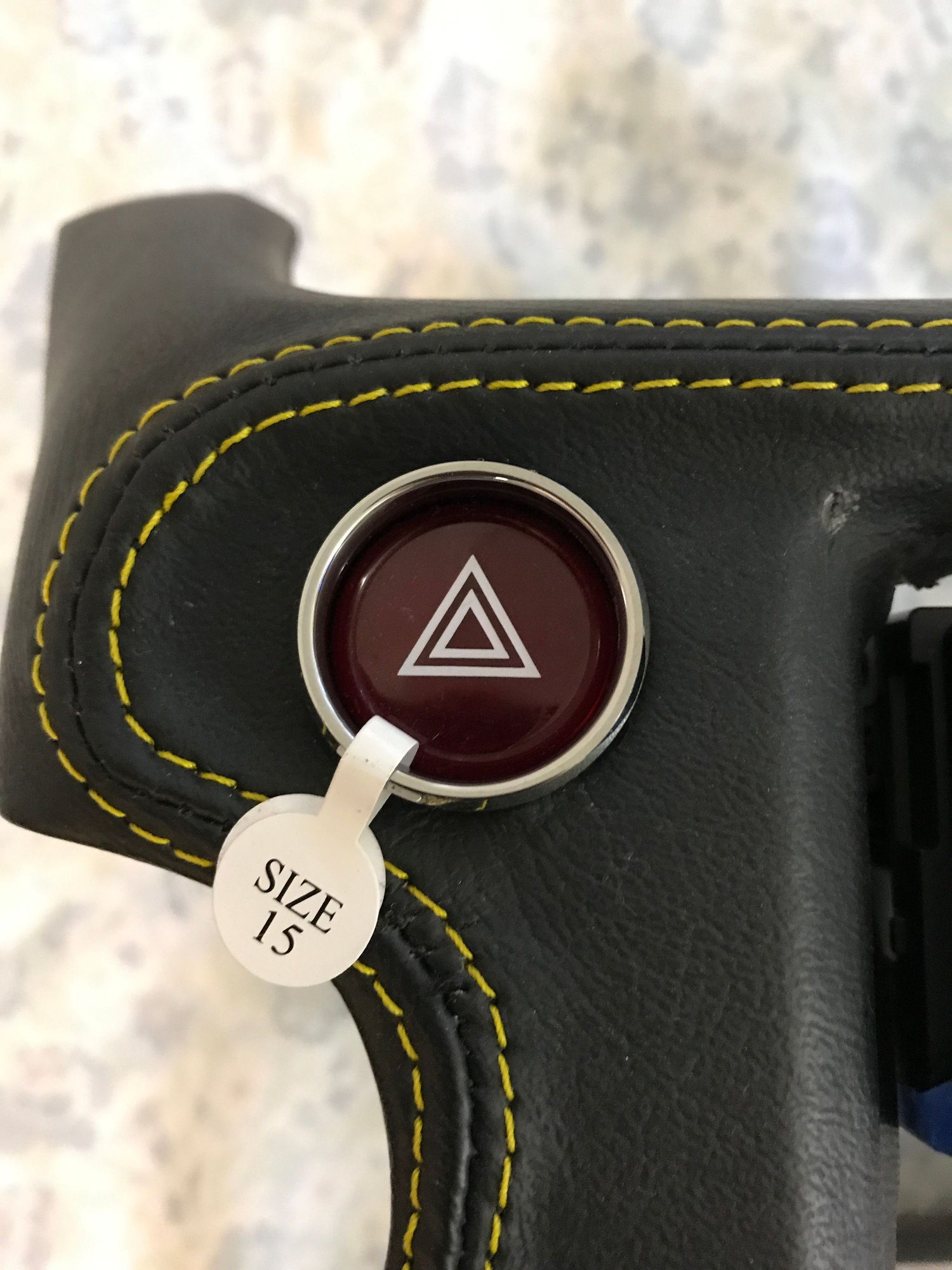

Installed all the sensors for Defi Advance RS Gauges and temporarily connect to test the functions, still undecided whether r want to use the GREEN backlighting or the Classic White backlighting...
I also see the Hazard Switch looks "unfinished" with this Leather Trim,...
so after careful thinking....
I bought a Tungsten Carbide WEDDING Ring on eBay,
not for my wife or me...
but for my JDM Hazard Light Switch Trim Ring
They are a match made in Honda Fit
I also finished wrap the Metra Trim with 3M
then secure all the trims and gauge plate with Epoxy glue,
and here are the FINISHED Center Panel...
