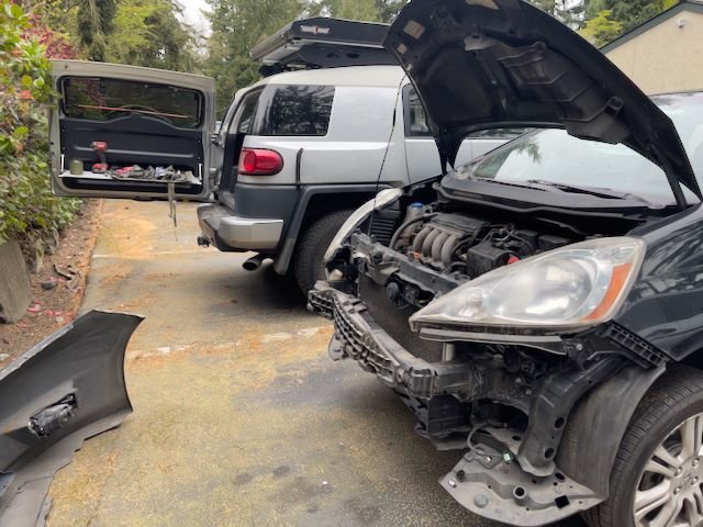

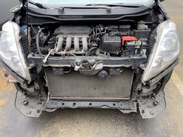

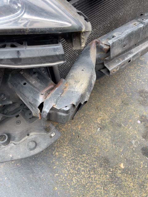

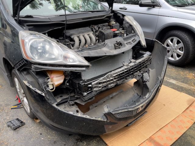

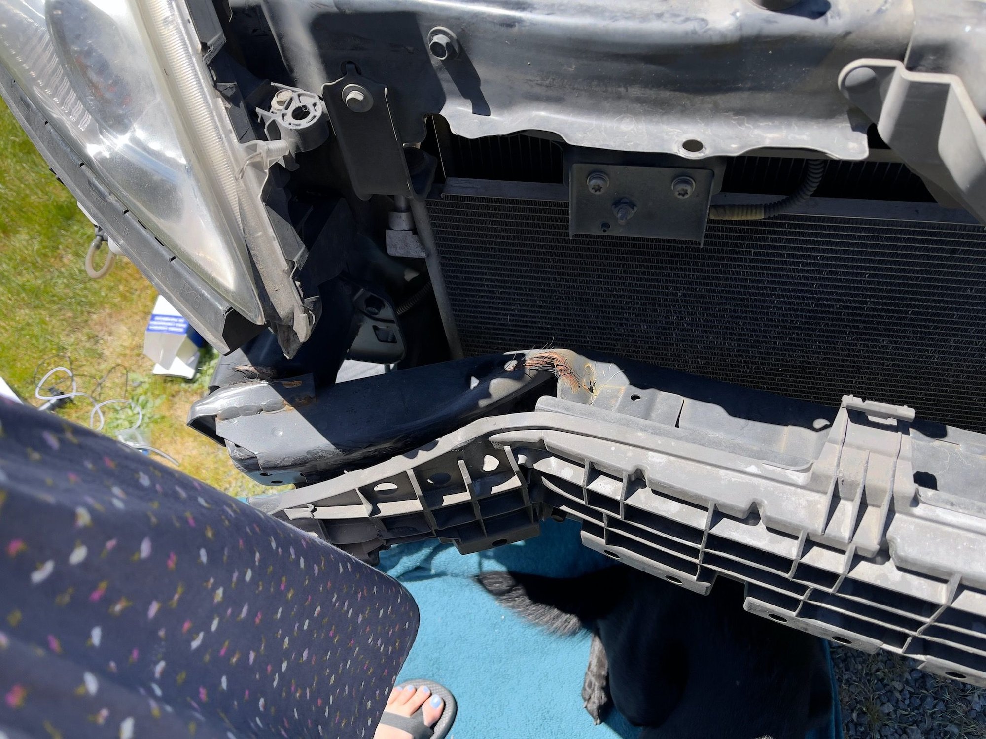

Had another routine maintenance day. This time, I did some work I haven't done before, which entailed removing the front bumper cover.
Here's what I did:
  • Oil and oil filter
  • Inspect suspension
  • Cabin Air filter
  • Rotate tires
  • Washer fluid pump
  • Inspect coolant, top off
Our washer pump only worked a couple of times since we bought the car back in July of 2019. When placing a hand on the pump while someone else engages the washer handle, the pump didn't vibrate or make any noise. So I purchased a universal pump with plans to replace it. I get the bumper cover off and realize that it's just unplugged... Works fine.
At the same time, I notice that our bumper itself is dented quite a bit.
On top of that, almost all the clips on our bumper cover are broken, including the ones that hold the brush guard up underneath. Taking that into consideration, as well as the fact the washer pump was unplugged, I'm willing to bet that the previous owners replaced the bumper cover themselves, and didn't report the incident to insurance. We had the CarFax when we purchased it, and there was nothing significant in the history. So, that's a bummer.
But, hey! I replaced all of the clips on the bumper, the brush guard, and in the wheel wells.

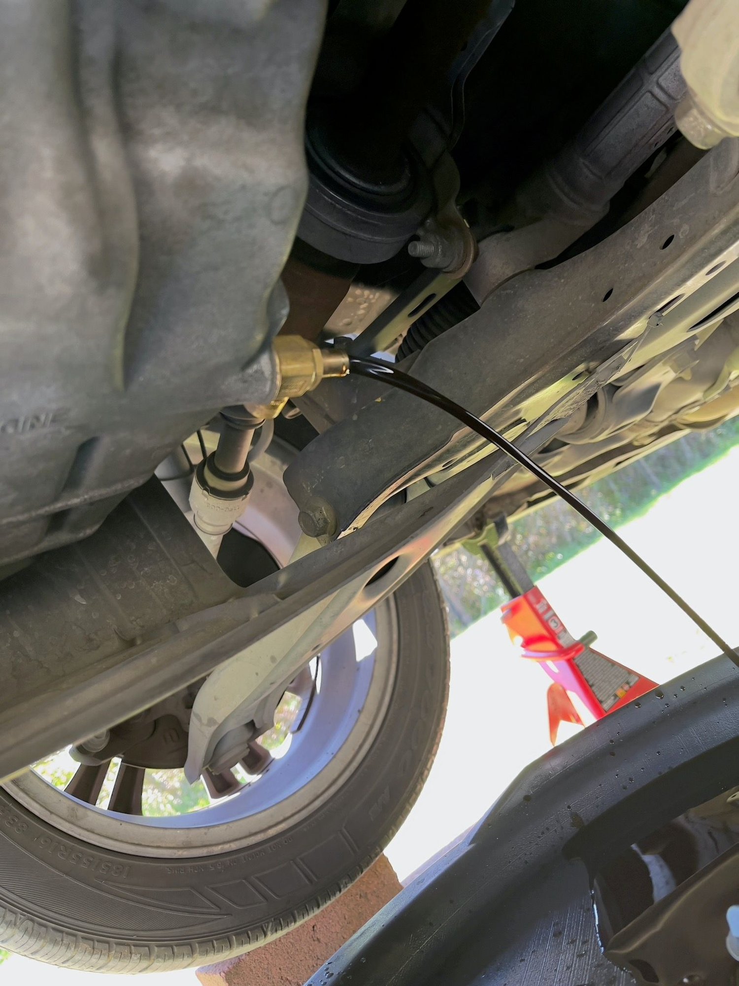

Fumoto drain valve. I've used these on all my cars.

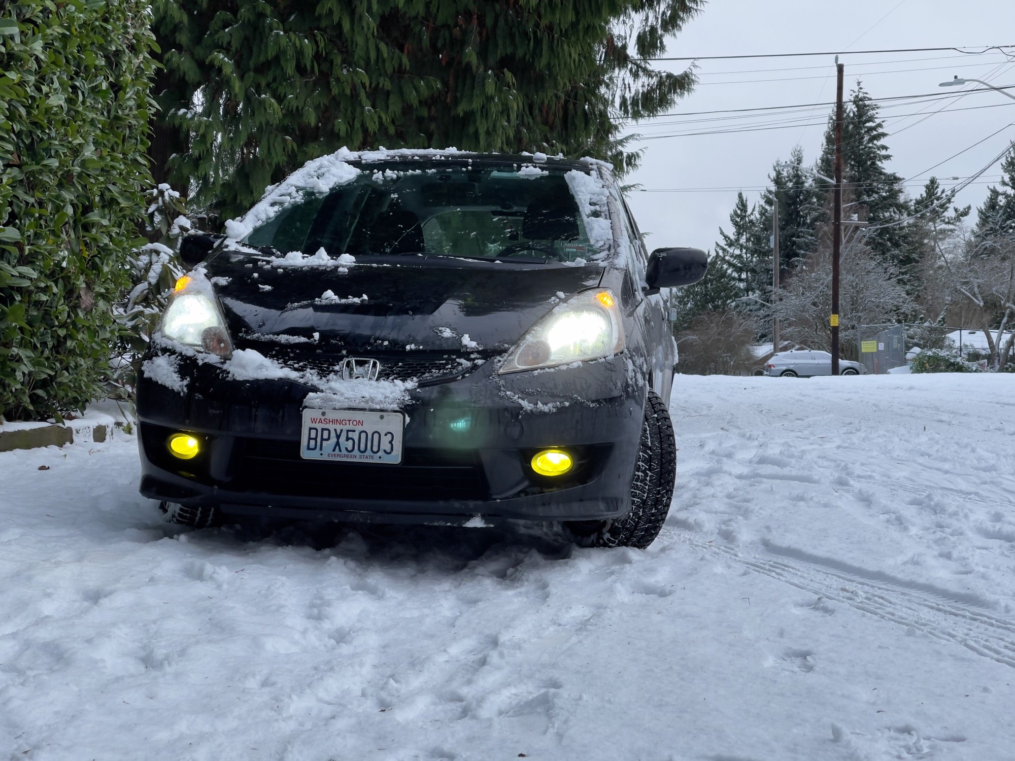

Put some yellow LED fog bulbs in. Don’t worry, they’re not 20 million lumens. They’re only 1500.

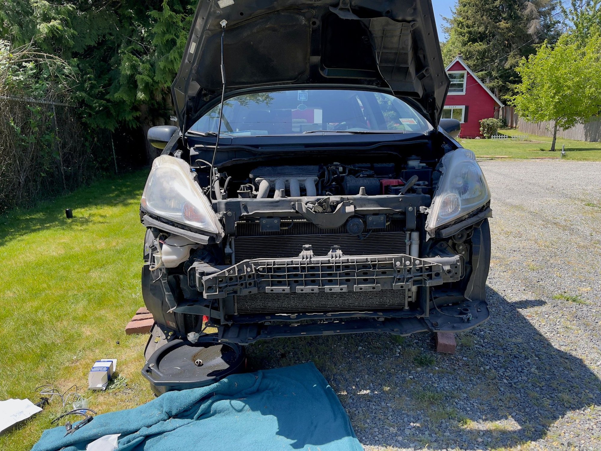

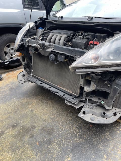

Last weekend, I finally got around to replacing the bumper reinforcement. But, also, the condenser. The A/C hasn't worked right for two years, and after 3 recharges and inspections, they finally found a leak in the condenser. I'm saying "screw it" to having shops do it anymore, and will be recharging the A/C myself, with UV dye, most likely next weekend.

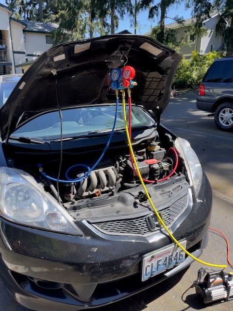

Recharged the A/C today. Here in Washington State, it is not legal to evacuate your own A/C. Not sure about charging it, but I do know that you cannot purchase R-134a refrigerant anywhere. You can purchase everything else you'd need, but not the refrigerant. So, I had to order some online from a retailer that would ship it to me.
I've never recharged an A/C before, so this was a new experience for me. Seems like Betty likes to throw curveballs my way! I utilized resources such as this video from
, and this one from
. Unfortunately, neither one of them is detailed in their explanation of how to add PAG oil, so I had to use
video. Thus, I was able to add in this PAG oil and UV dye. I added 25mL because I replaced both the condenser and receiver/dryer.
I used this manifold set and vacuum pump, which does not come with the correct tap for self-sealing cans. I had to run to O'Reilly for that, which they don't keep out on the floor. It was in the back.
The range of required refrigerant is 13.1 - 14.8 ounces. I believe this depends on the ambient temperature that day. Today it was 75ºF by the time I got to charging. Using a scale for both the first and second canisters, I was able to determine exactly how much refrigerant I used. By the time I had gotten to 13.6 ounces, the refrigerant was leaving the can very slowly. I took this as a sign that it was topped up. I closed up the valves on the manifold and checked this chart to determine proper fill level. It was spot on.
I spent a total of $406 on the bumper reinforcement and condenser from my previous comment, and all of the supplies and tools required for the recharge. The cheapest estimate I received from a shop was $1,500. Since we'd already spent $500 over two years having the system recharged, and neither time they did a true leak test, I said "screw it" and did it myself. Zero regrets!

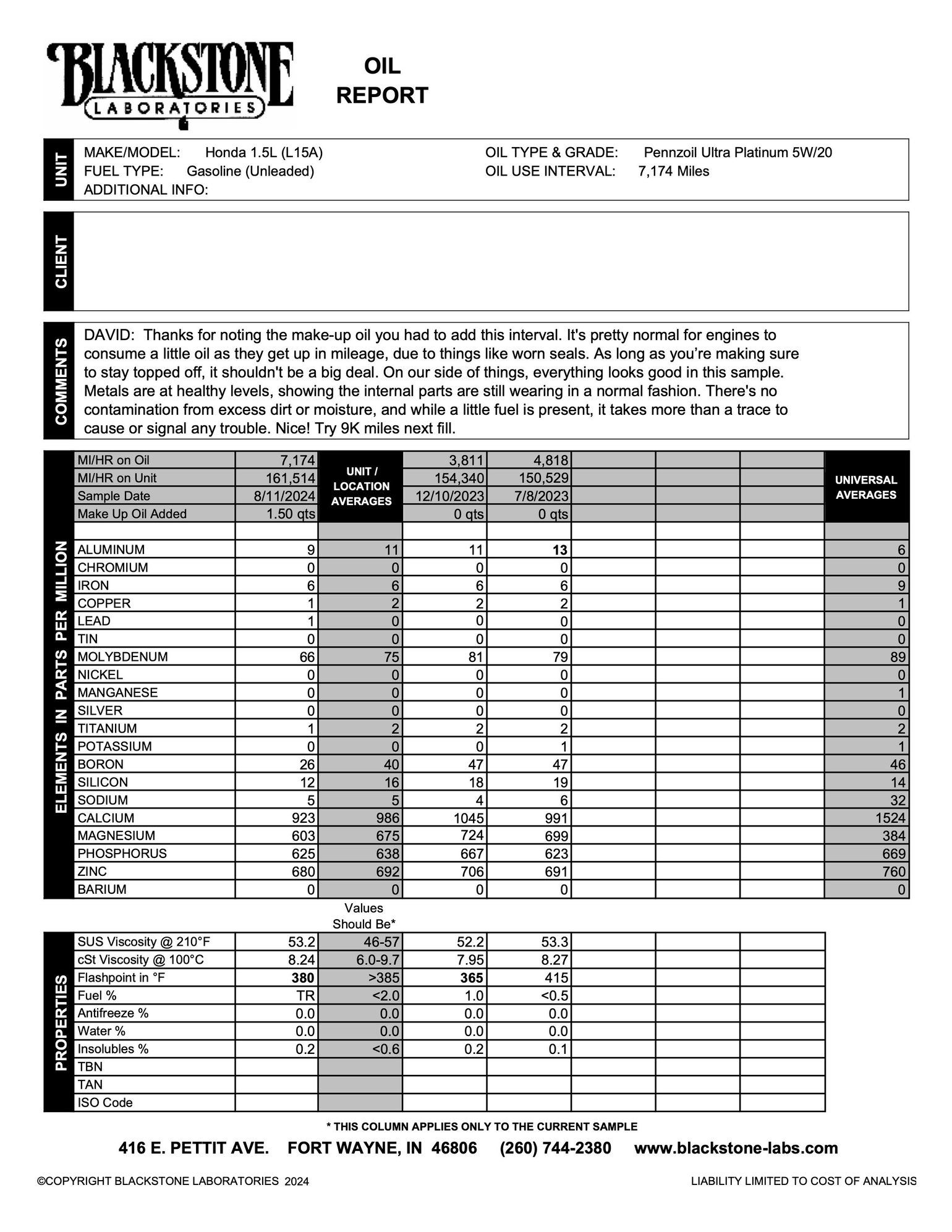

Got the most recent oil change lab results back. Betty's still going strong, but we did have to add 1.5 quarts between changes, and there's a bit of fuel in the oil. Anyone know what could cause that?

Haven't started the suspension refresh, but just did the most recent oil change. Sample has been sent to the lab.
This OCI was 6,814 miles. Betty burned 1.4 quarts of oil in that time. I spaced checking and did not top it off at any point between changes.
