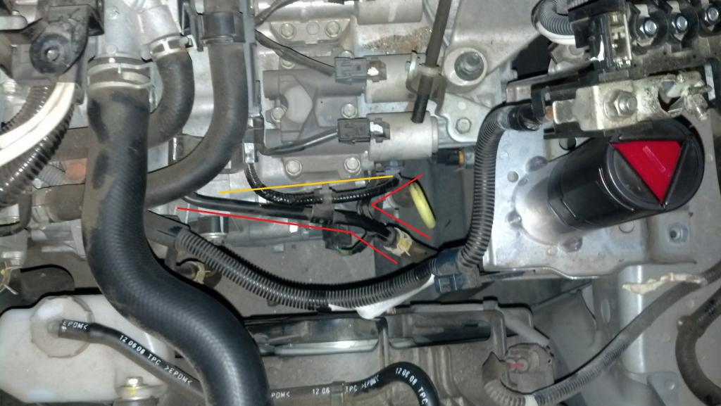

I tried installing it and cannot get it to fit. I love the pics by the way on the previous install. Here is where I am stuck! Waiting for a reply from Takeda.
Red is where the lines are (blocking the pipe) and the yellow is where the intake should be flush against so that it can line up with the mounting bracket and TB.
Can anyone help?

I was going to get the Takeda (great intake, cool extras), but the drop on that pipe concerned me whereas going through some standing water unexpectedly and possibly hydrolocking the engine. I don't think they're available for AT anyway... so maybe my concerns were for nothing to begin with.

is that an automatic? yeah the brackets or the lines from the intake to connect to the car are for a manual transmission fit.
