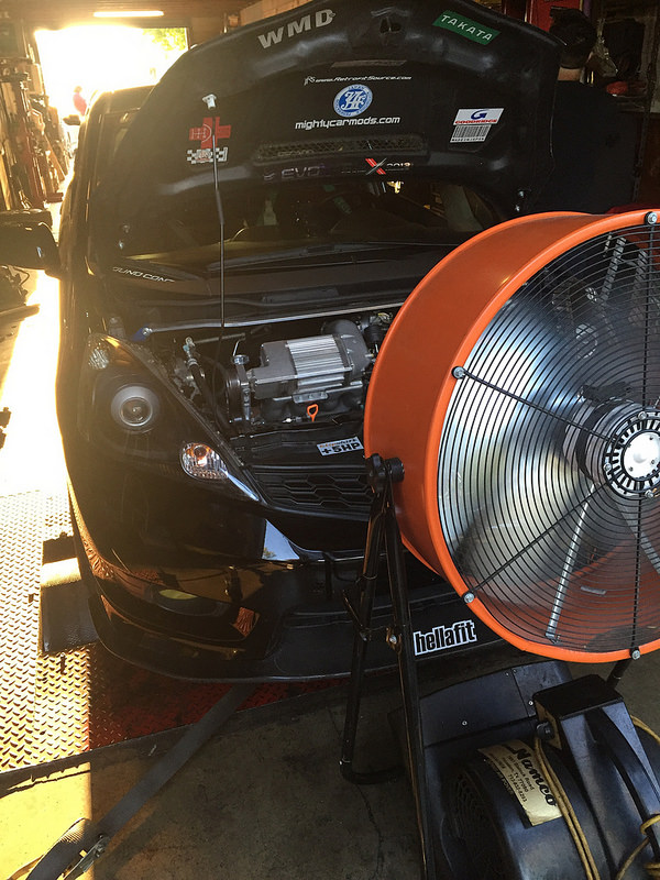

Old Jul 8, 2016 | 02:35 AM
  #124
07fit916's Avatar
Joined: Jan 2007
Posts: 493
From: Elk Grove, CA
Attached Thumbnails 07fit916 GE Progress Thread-28166794015_89f57cf3e2_c.jpg

Hello,
How is the tuning goes?
Have you dyno yours?
Thanks
Still in tuning process. It's been getting better with every new revision but I've noticed heat soak is such a killer on this setup. It feels very good in the morning getting on the freeway to get to work, but on the way home it feels like all the power is gone. I will get it on the dyno once the tune is finished.

Hi,
Yes, the heat soak is quite a problem.
When I tune it at Church Tuning on their dyno,
it got heat soak that one of the mechanic there hold a fan and direct the air to the supercharger, and later when it is not enough he have small water stream from small hose to directly pour water on top of the supercharger just so the tuner can get consistent tuning number.
When they tune my car, they concentrate on getting rid of all the knock...
which they can heard physically during the dyno session.
Will online tuner be able to know when there is knock?
Our heat soak problem do have big effect in knock...
Back to heatsoak,
That is why I plan to buy the JDP Carbon Fiber Ventilated Hood later this year
(I think you already have the JDP Carbon Fiber Ventilated Hood right?)
and also have a Setrab Oil Cooler with Fan system also later this year.
How is your Top End Feel?
My Top End power don't feel much different compare to stock...
the most different I feel is in the low to midrange power and it is just so much smoother in power delivery and transmission shift quality...
but he top is not much different. I am AT Transmission though,
Yours are manual right?
and do you have Air to Fuel Ratio gauge?
What is your AFR on the low to mid rpm (Close Loop) and when at Wide Open Throttle/Open Loop?
Thanks
KTuner datalogs the knock sensor in the software. I'm assuming that's the only way the tuner would see it. Not completely sure.
Yes I have the JDP vented hood installed.
Top end is mostly how you described it. Torque drops off around maybe 5500rpm.
Yes manual trans.
I don't have a dedicated gauge. But I have an obdii transmitter that can send data to my phone via Bluetooth.
Afr in closed loop is anywhere from 12-14.
Open loop mid 11s

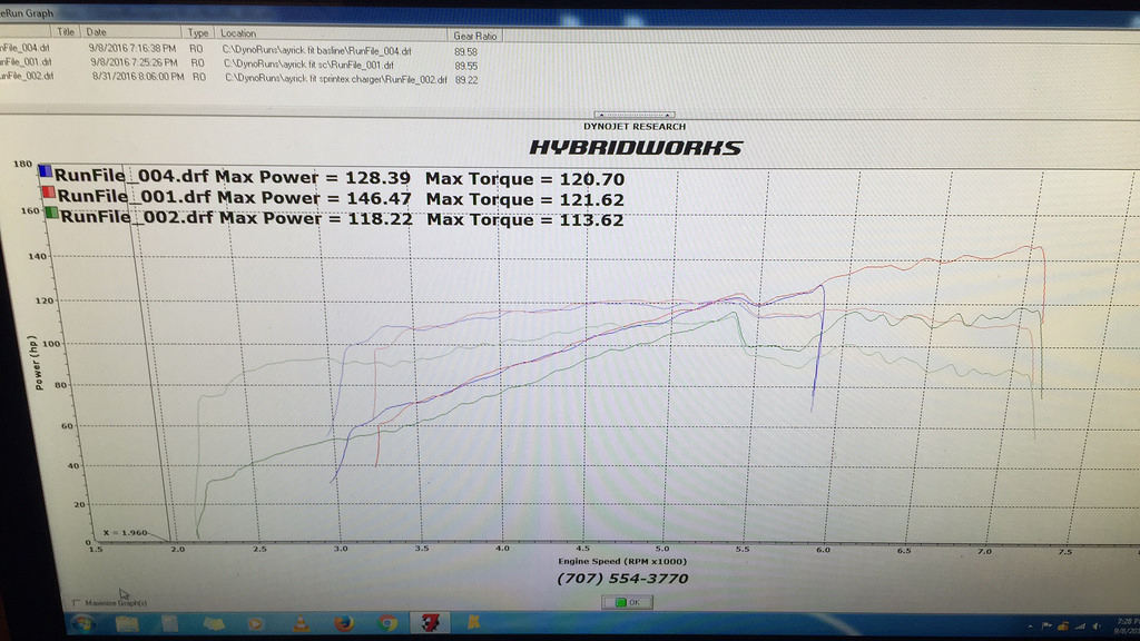

118/113 is from last week when i went to get some dyno pulls to see how my etune would do on a dyno.
150/122 was the final.

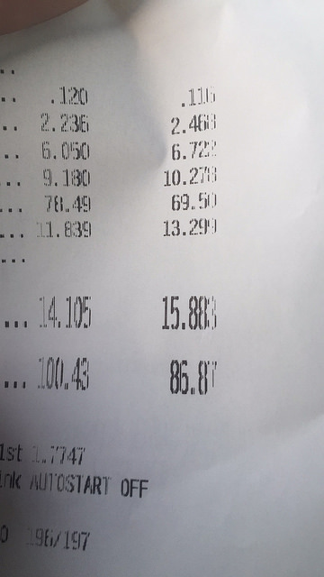

Old Sep 28, 2016 | 09:28 PM
  #137
07fit916's Avatar
Joined: Jan 2007
Posts: 493
From: Elk Grove, CA
Wanted to break 15s. Too bad i needed the sc to do it.

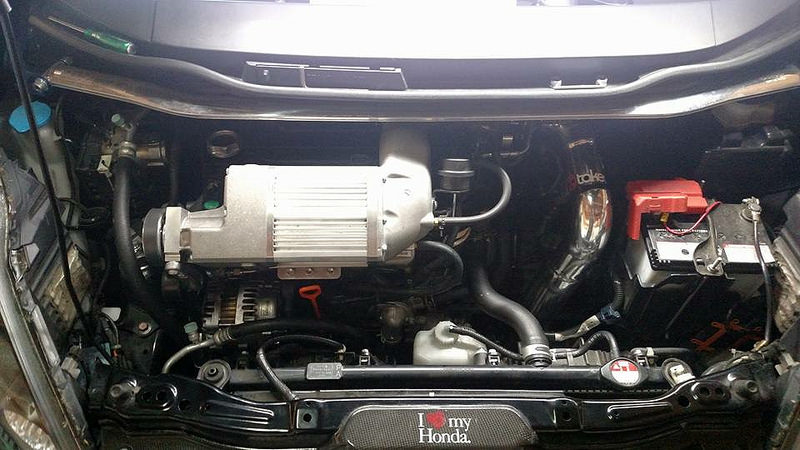

Old Sep 28, 2016 | 09:32 PM
  #138
07fit916's Avatar
Joined: Jan 2007
Posts: 493
From: Elk Grove, CA
As it sits right now.
Attached Thumbnails 07fit916 GE Progress Thread-29352802604_3eda20dd72_c.jpg
