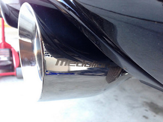

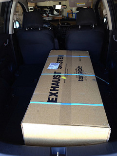

Exhaust is delivered. Go amazon prime.

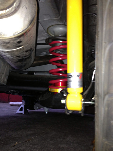

Redshift coilovers finally delivered and installed!
Camber bolts and RSB also installed. BIG thanks to DoYouFit?, konig_feather, martamus, and TPColgett for all the help!

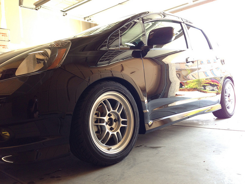

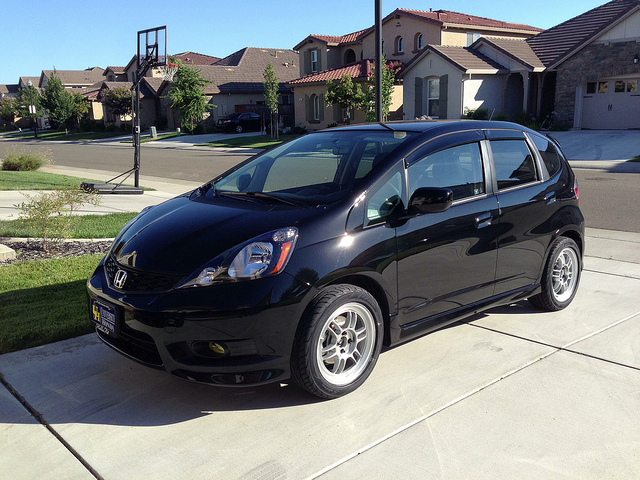

7/20/2013:
Alignment today. -3 camber up front.
Rpf1 16x7 +35
yokohama s.drives 205/50/16

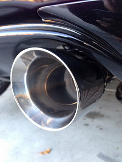

Greddy SE axle back (arrived today. may update later.)

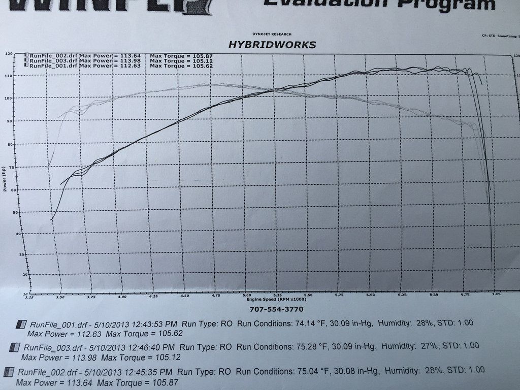

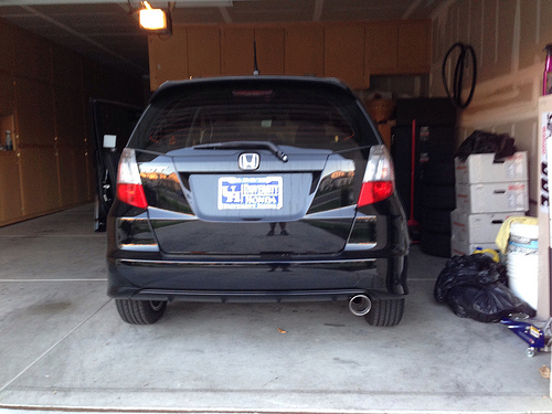

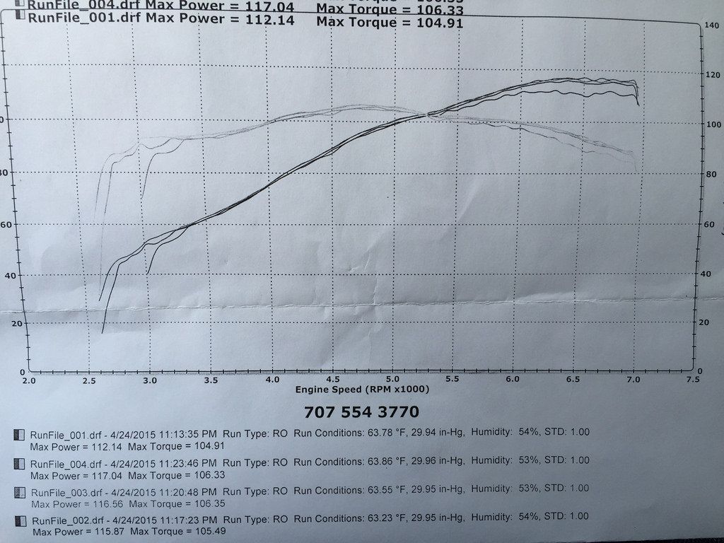

first dyno day with takeda cai and t1r b pipe/greddy axle back
2nd dyno day with added t1r header/pcd and secondary cat delete and street tune with ktuner. first pull was done with no tune (112whp). then 3 pulls on the street tune. i actually went back to the shop a couple weeks later for another dyno day and pulled 116 again.
after cam and valvetrain install. was the tuners first time seeing/using ktuner software.

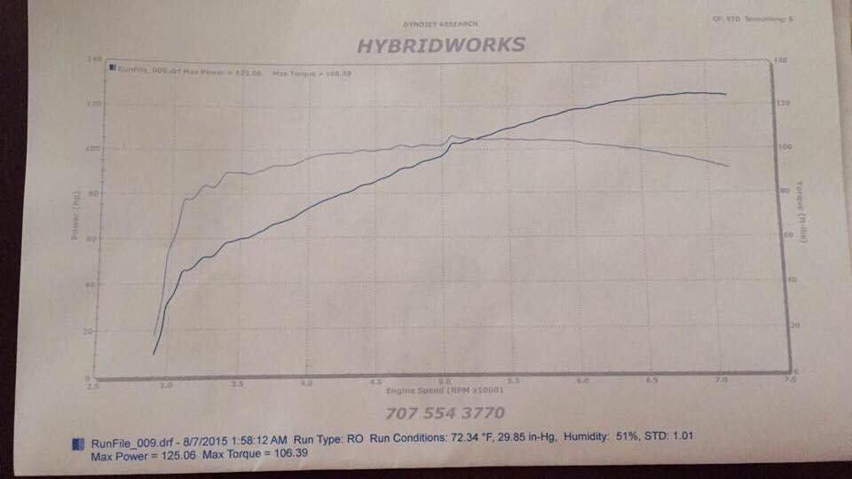

Sprintex SC with ktuner. Stock motor.
Feel free to comment lol. Figured i'd have a progess thread this time around.
