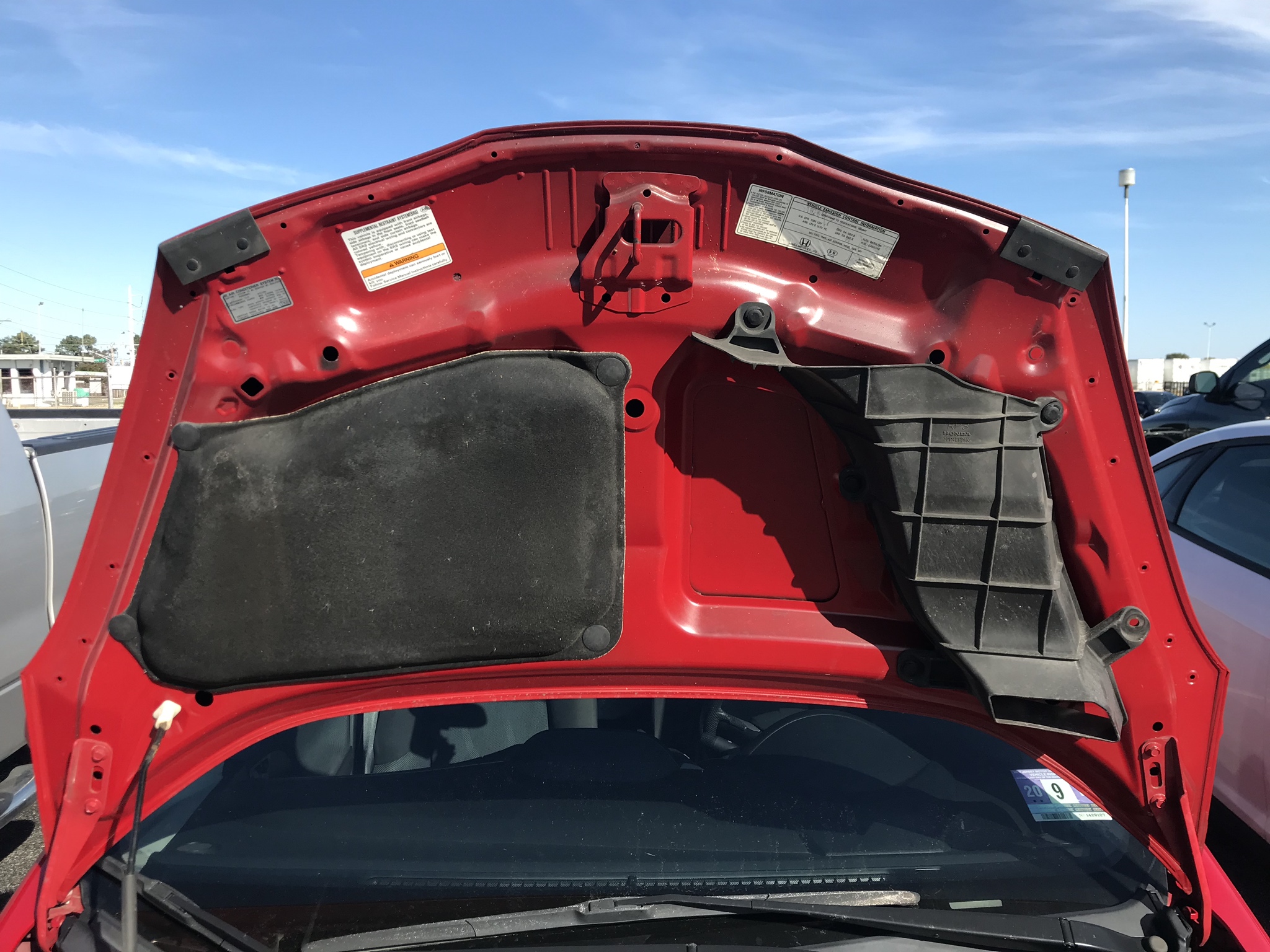

Some miserable crook stole some parts out of my 2010 standard Fit right in my driveway! A cowl side panel cover is gone by the hood's driver side lift mechanism, and that hard rubber air intake fastened under the hood was left hanging down! I now have a loud rattle and don't know from where or what else may be missing, so I'd appreciate it if someone could show me, or point out to me, where a photo of the underside of the engine compartment hood of a 2010 standard Fit might be found?

I can take a picture for you of my Fit’s hood.

Thanks, I'd appreciate seeing that...

sorry to hear about your experience. it sucks having to worry about thieves. had a similar experience recently too.
did you get your compartment situation figured out? if anything if you are able to take a picture of your compartment we might be able to see if something is out of place.
for the air scoop thingy if they broke the mounting clips...an easy fix is to get interior trim "push in rivets" to hold it up. i ordered some similar to the original style when i broke one of mine recently, but used a push in rivet to temporarily hold it up till the oe style ones came in. it held it so well that I ended up just leaving it. just measure the diameter of the holes so you get some that fit snug.
