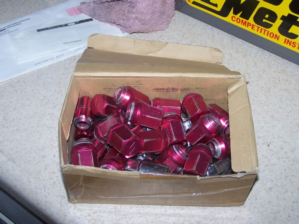

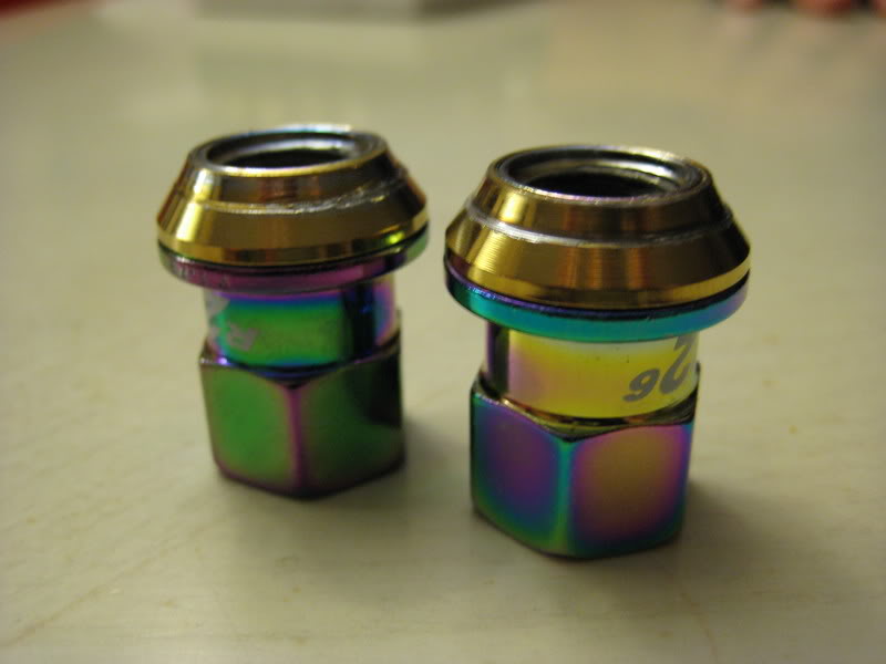

Originally Posted by NewFitGuy09
^ how bad is it to aftermarket lugs on oem wheels?
this bad...
even KICS has no match for oem wheels...
there is of course a solution if you intend to run tuner lugs on oem wheels... ADAPTER WASHER TO CONVERT 60 DEGREE TAPER LUG NUT
Old Mar 8, 2012 | 02:33 PM
  #1333
NewFitGuy09's Avatar
Joined: Feb 2011
Posts: 75
From: Orlando
Ok so what kind of lugs would you recommend for the stock sport rims? Round?? I don't want my wheels to fall off lol
