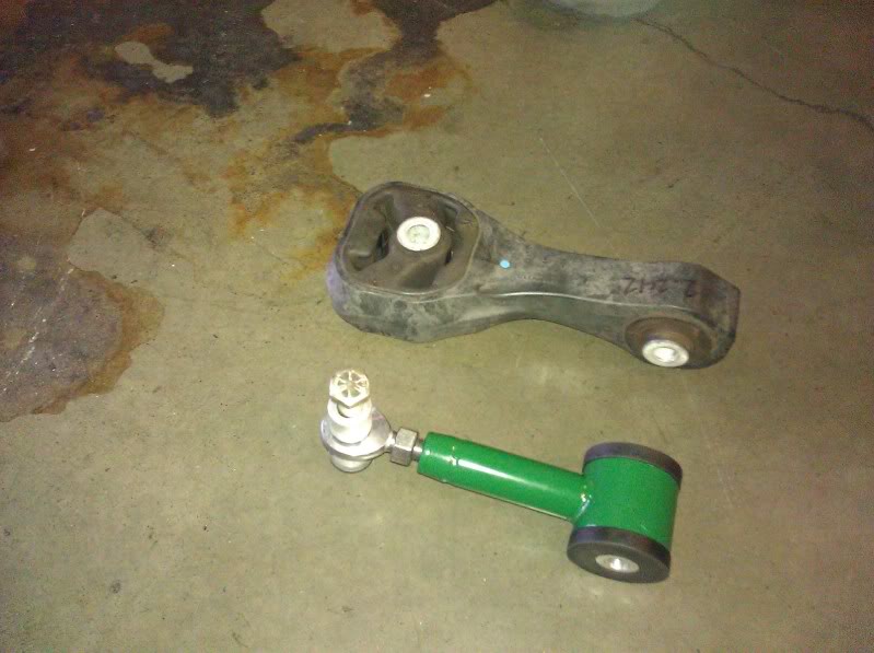

I had a prototype installed earlier tonight and I love it. I feel a little bit of vibration but its not very noticeable. The car feels much nicer now with no wheel hop and better engine response. My car is an automatic and its a dramatic difference that I have felt over stock. The mount itself is stiff but very much bearable when driving since I have a newborn that I drive around in the Fit. It was a concern of mine when getting the motor mount installed but a little vibration is worth it.
I will have to post more after I get the chance to drive my car some more but I wanted to give my initial impressions.

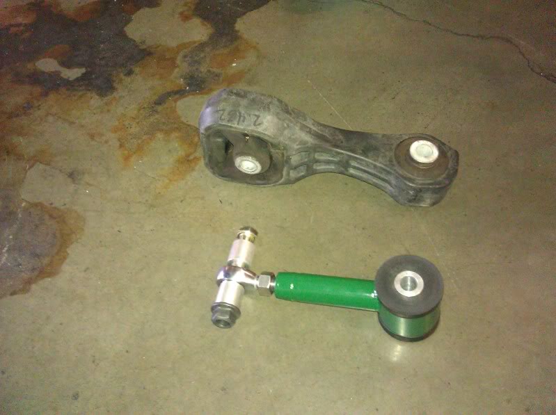

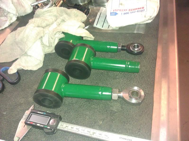

ohh and manual and automatics have the different motor mounts, no cost difference though. thanks Eric! one more guy is going to get one installed and write a review, possible thursday we'll have another update
my bad i forgot to give new specs too pictures below, heim joint has been used to reduce vibration, makes for easier install too, and will allow you to make adjustments depending on how you want to adjust it
