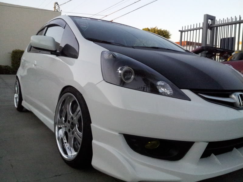

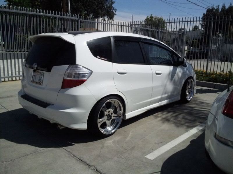

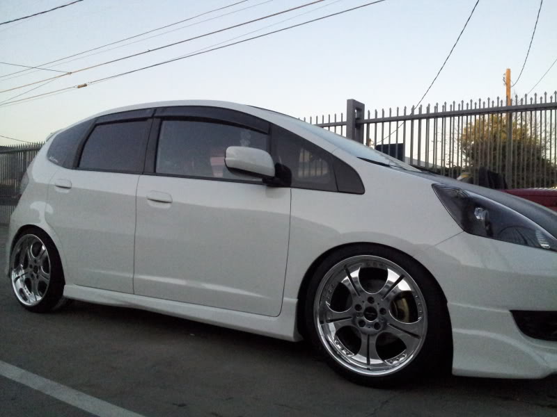

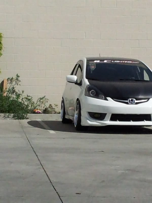

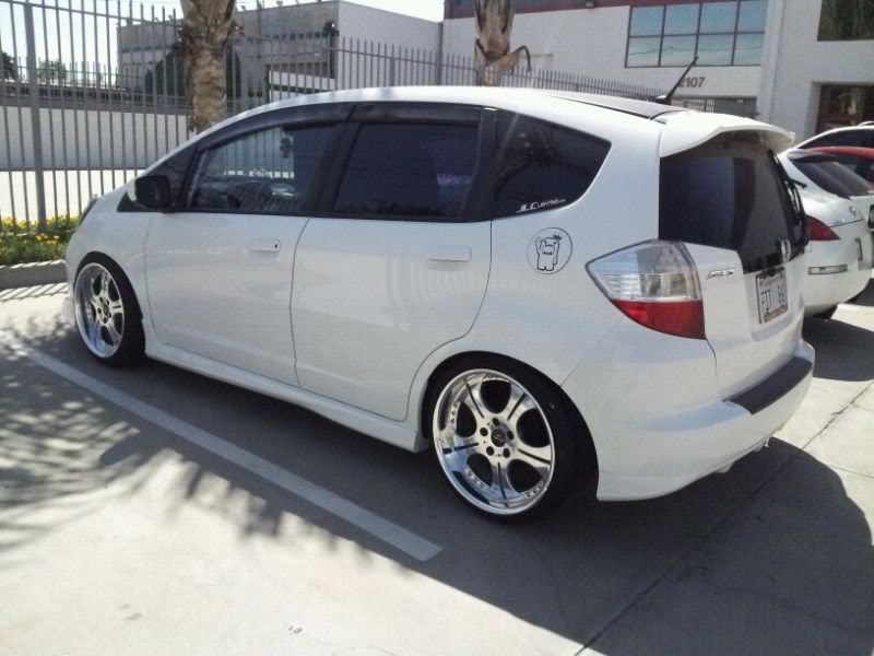

im not that low...but definitely lower than springs...
