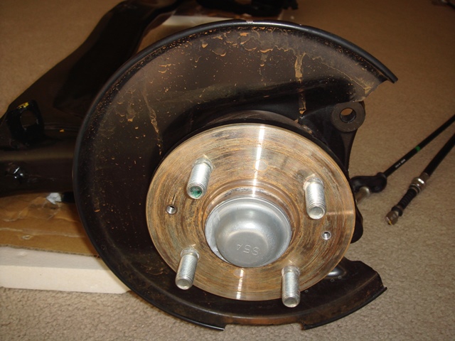

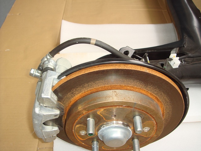

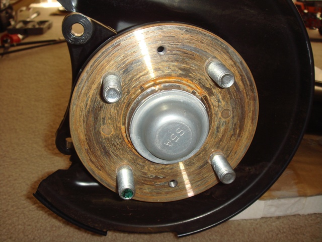

I forgot that I already had answer to this question myself since I had taken out my rear disk brake assembly...
Ok, so the part of the hub that hold the rotor is 61mm in diameter and it is not flared.
Here are the pictures:
