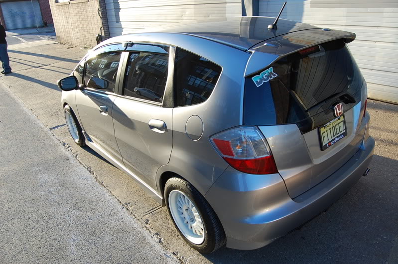

I have nothing against the Koni Street just with the yellows having the capability to adjust the ride firmness is what I like. For the fronts I would probably like a set of the streets because if the adjustment on the yellows is on top it will be a pain to adjust based on the location. If most cases would never adjust it.
On my GE I have consider 15" based on some of the pictures I have seen did not look bad.

Nothing wrong with 15's on a GE! I happen to REALLY like that look.... You just have to keep in mind the accompanying tire size diameter 205/55R15 has a 23.9" Diameter which is close enough to not terribly throw off the speedo/odometer. It's a 4.4" side wall as opposed to a 4" one so it would look a bit chunky, but that is WAY better than being almost an inch smaller in diameter than the OEM tire!
