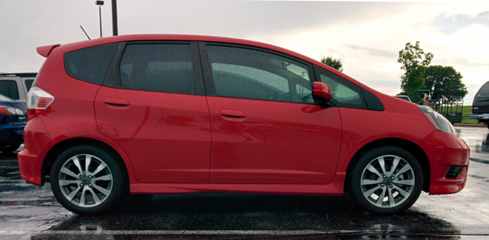

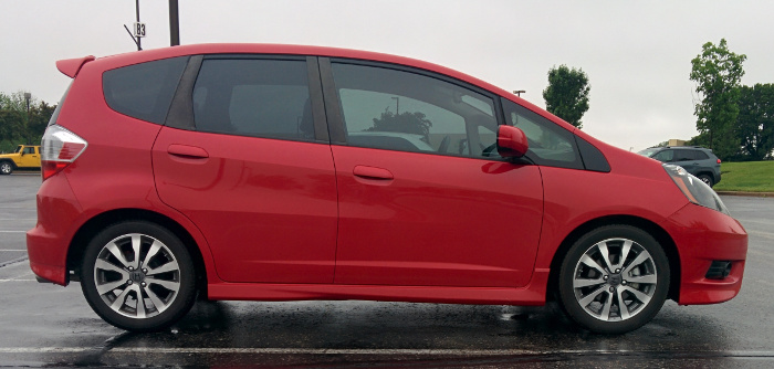

Everything is installed. This car is as fun to work on as it is to drive! Very, very easy car to work on.
This car has had a rough 45,000 miles so far (I'm the second owner). It looks like it spent damn-near every single day on rock roads because we were finding rocks, gravel, and mud EVERYWHERE. The underside is filthy! More than once I was pelted on the head by a rock as I removed something. Three out of four struts were leaking, the bearings on the front struts were completely toast, and there wasn't much life left in anything. I'm glad I ordered new hats and bearings for the front struts, that's for sure. I couldn't find any new stuff for the rear so I swapped over what I had (dust boots, bump stops, bushings at the top). The bushings are quite loud still so I'm going to have to grease them up I think.
My impressions are that the ride is firmer than I thought it'd be. Granted the Fit ride quality was never amazing, it's pretty firm. I feel like a softer spring and no aftermarket sway bars on that rear beam would soften it up quit a bit, but I have no intentions of making that change because the handling is just flat-out AWESOME with this setup. This car reminds me a lot of the 2013 Focus ST I owned in that the response from the rear end is immediate and without delay. You turn and it tracks immediately.
I'm calling around now to find a shop that can set the front up with a 0 toe alignment. We got the camber kit pretty well dialed in. I was hoping for more negative camber than what showed up. Is it safe to throw camber kits in both front bolts on the bottom? They aren't the right size so that seems a bit sketchy to me.
This car is going to be a riot at autocrosses!
