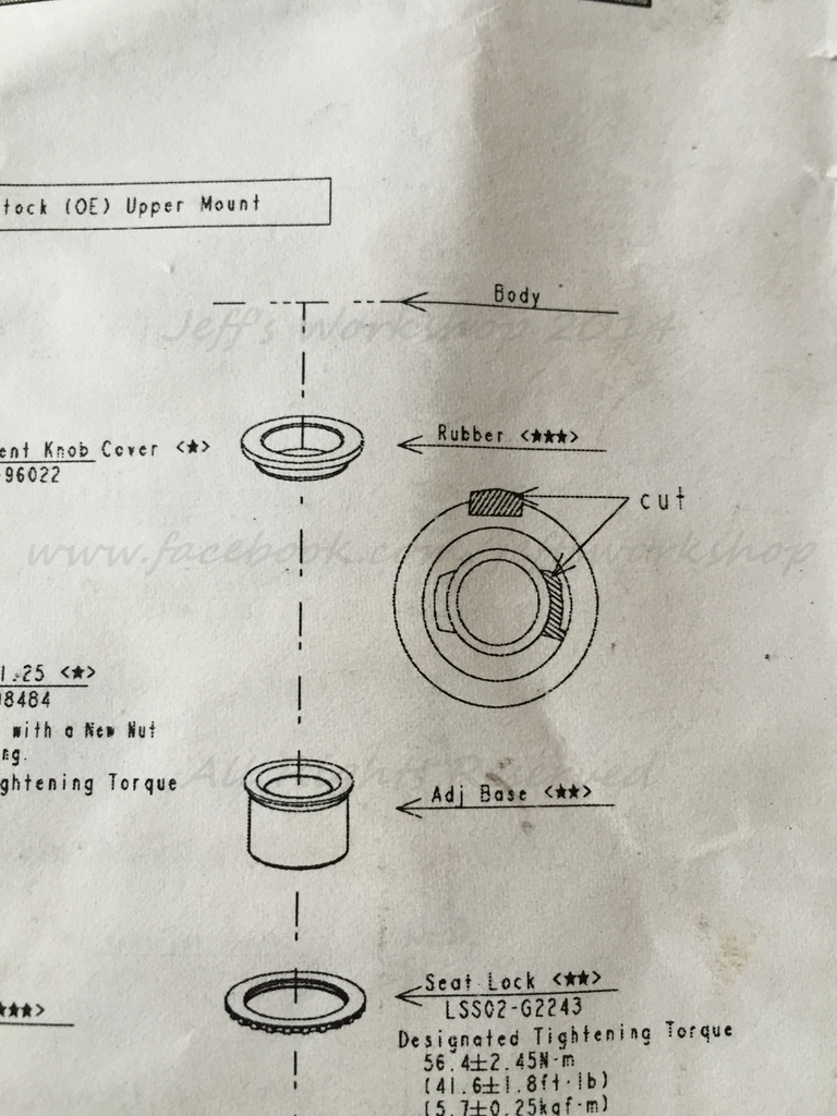

Second question is anyone with Tein coilovers knows if the upper rubber spring mount sits flushed for the rear?
Here's a link to what I'm talking about
Honda Automotive Parts
It's part 005.
that rubber doesn't sit fully flushed on the Tein coilovers top spring. Am I suppose to cut it? That rubber mount has certain areas where it's bulging out.

Yes, you're suppose to cut the rubber part sticking out from the top mount. It is described in the Tein Manual:
