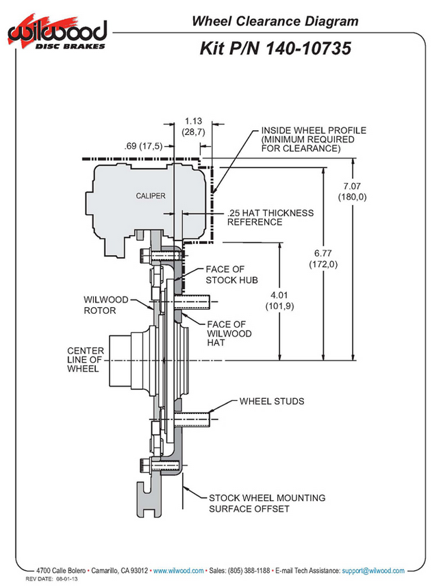

I'll just assume you're made of money, and went with the 140-10735
https://www.wilwood.com/Images/Brake...637_wcd-lg.jpg
if you cant take measurements yourself.... perhaps show that wheel clearance diagram to your wheels seller, and they should be able to assist with your question about clearance/fitment

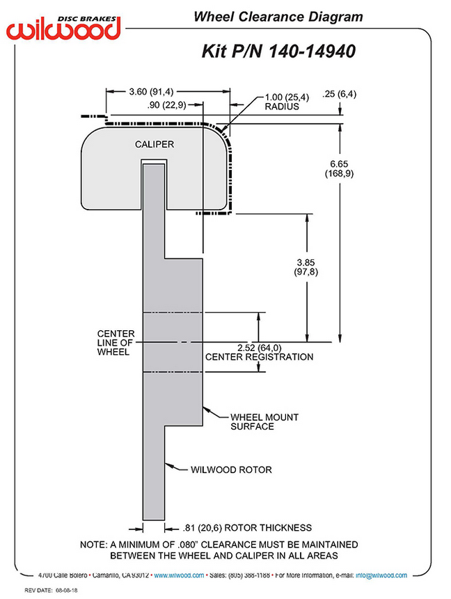

actually, it would appear the 140-14940 is more expensive.... therefore .... surely you went with that. so yea, show this diagram to your wheels vendor instead
https://www.wilwood.com/Images/Brake...272_wcd-lg.jpg

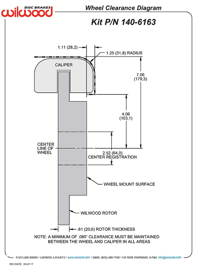

So sorry for not posting the kit number. I have the 140-6163. Thank you for the quick replies and diagrams.
Old Oct 18, 2018 | 03:49 PM
evilchargerfan's Avatar
Joined: Apr 2018
Posts: 2,615
From: san diego
so yeah, save this diagram, and show it to the guy you're gonna buy wheels from.
https://www.wilwood.com/Images/Brake...375_wcd-lg.jpg
Old Oct 18, 2018 | 03:52 PM
B.Ruck's Avatar
Joined: Jan 2018
Posts: 30
From: Birmingham, AL
Awesome thank you very much.
