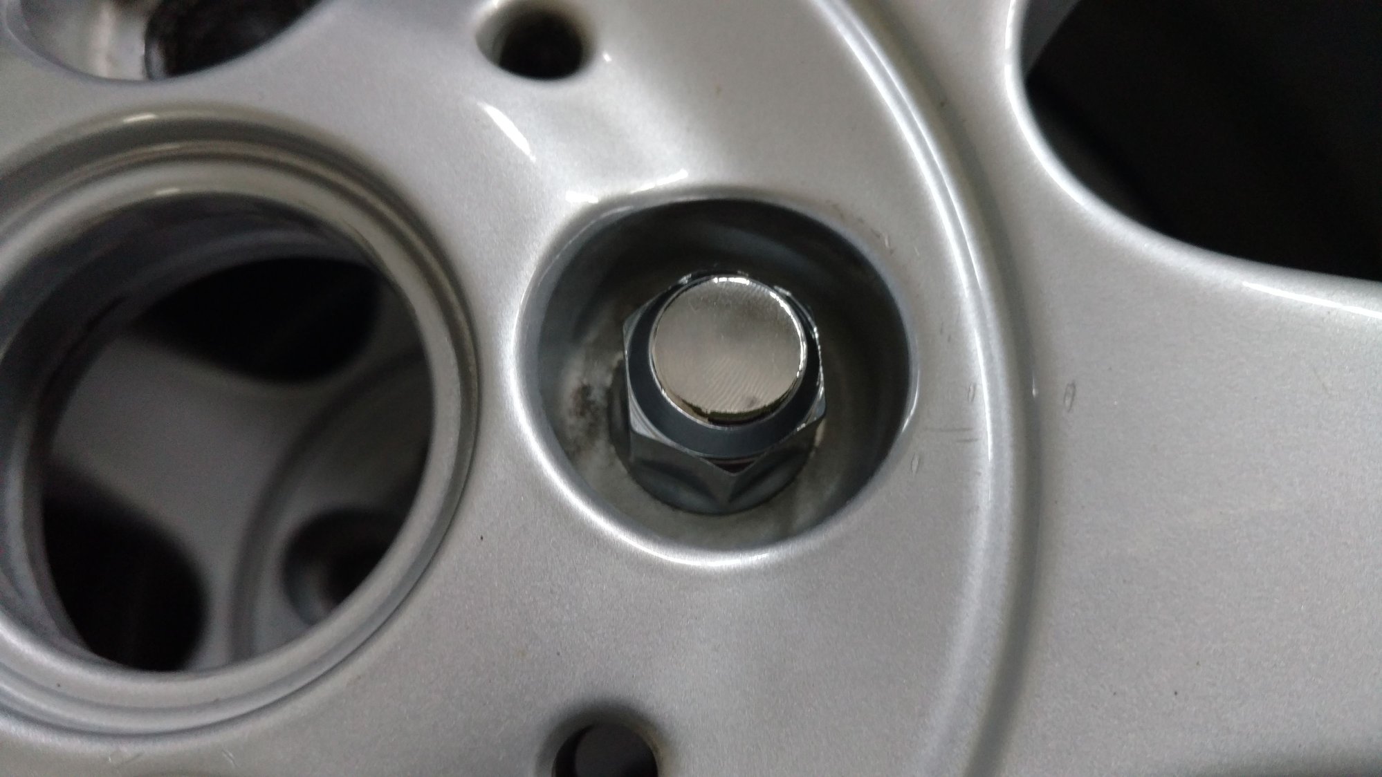

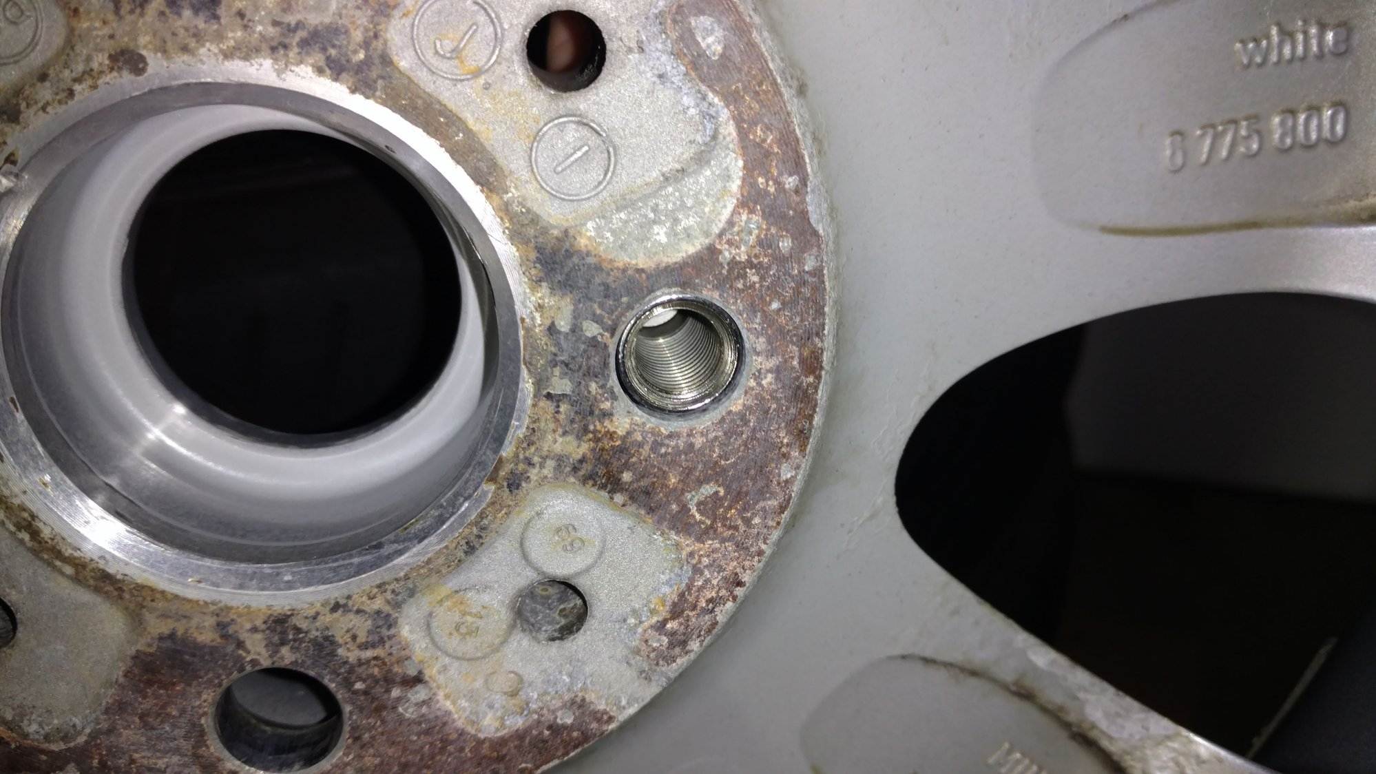

Tires have been ordered and should be delivered tomorrow. In the meantime I figured out which lug nuts to get. An older thread only listed a dead Jeg's link with no description, you need lug nuts with a 60 degree taper seat, or acorn bulge seat, and ET or extended thread shank that allows the nut to engage more threads on the stud. Because the Mini wheels use 14mm bolts and the Fit uses 12mm, the extended thread shank fits perfectly in the wheel hole. The shank on the lug nut measures approximately 5/16" while the thickness of the wheel from the bottom of the nut seat to the back of the wheel measure approximately 3/8" allowing 1/16" so the lug nut does not bottom out on the disc/drum. This will probably be better explained with pics so this is what the lug nut looks like.
Here is a pic explaining what I meant when I said there is approximately 3/8" from the bottom of the lug nut seat to the back of the wheel.
Lug nut fully seated. You can see shank does not bottom out with approximately 1/16" to spare.
Here are a couple of views of the lug nut on the front of the wheel. I like that there is plenty of room to fit a socket to install/remove lug nuts.

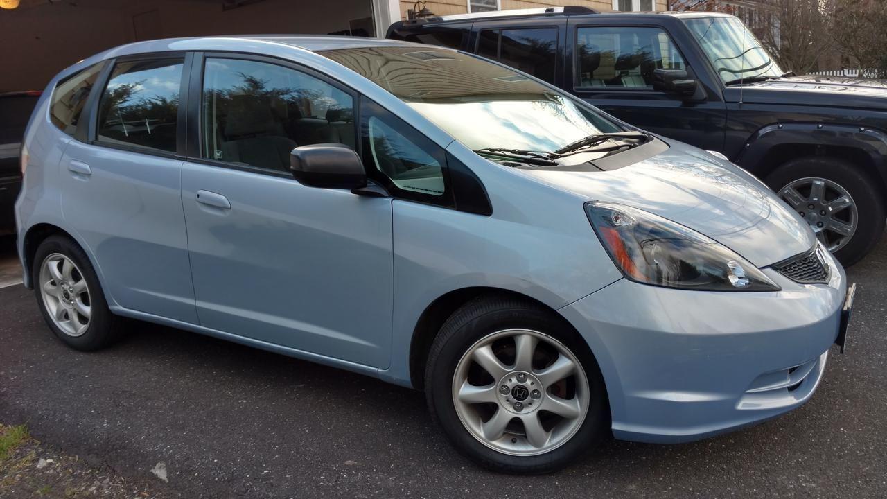

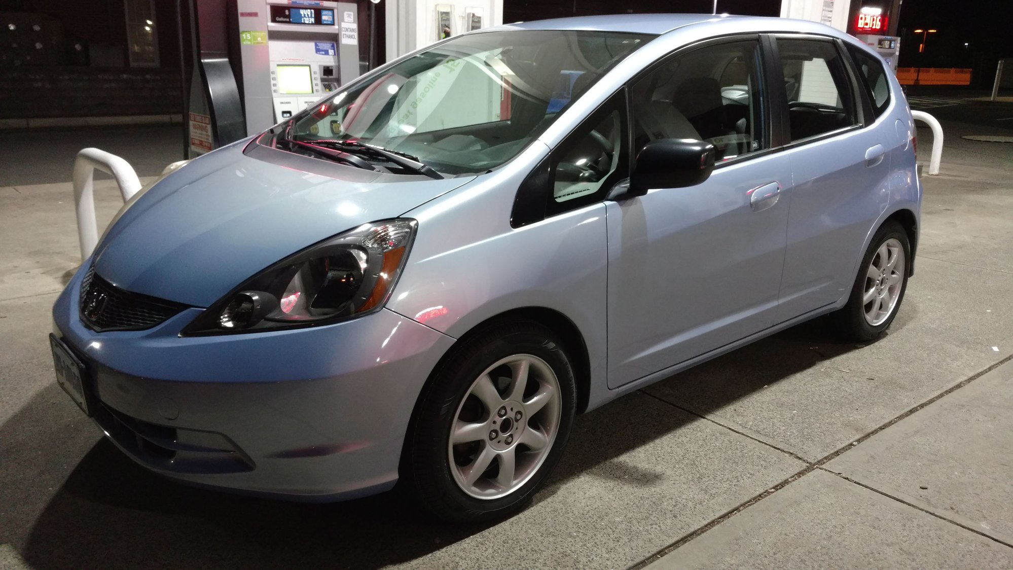

Finally got the wheels mounted on the car last night. I purchased 205/55-16R tires from Walmart and three of the four tpms sensors leaked so I took them back and had them install regular valve stems which do not leak. I like the bigger tires as they fill in the wheel well nicely. Still waiting for Honda center cap decals to arrive in the mail.

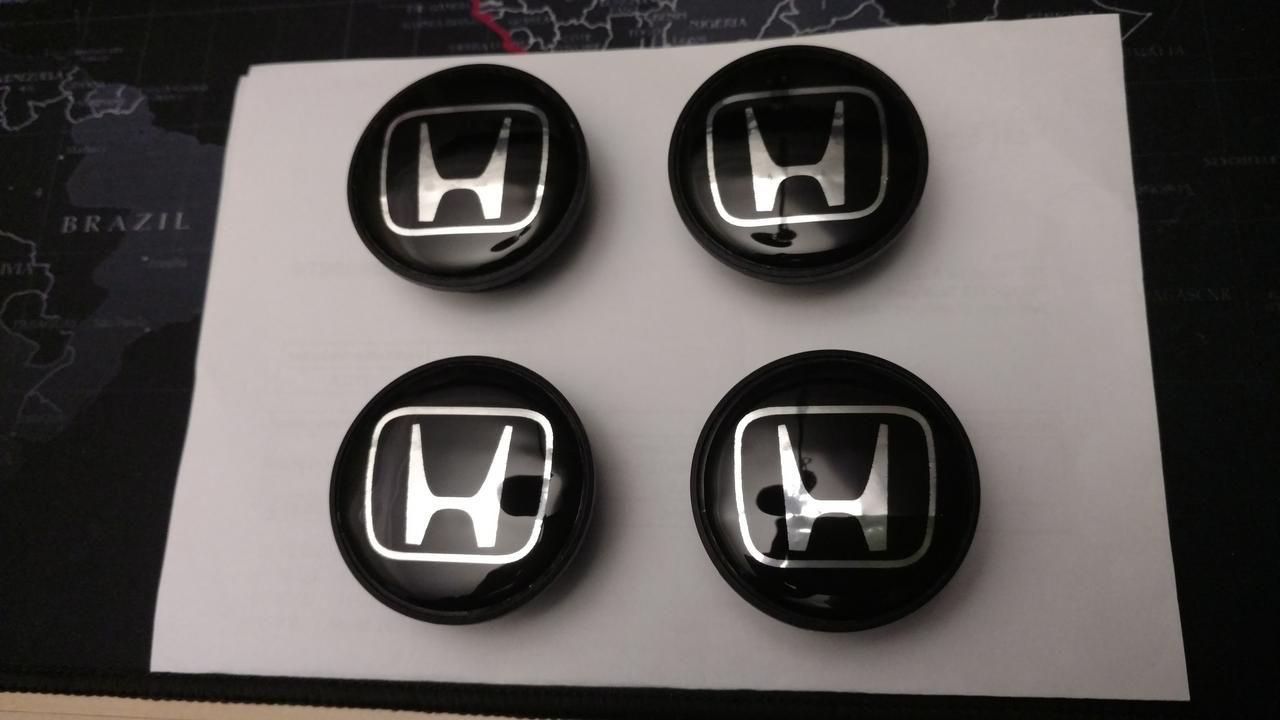

The center cap decals finally arrived last week and the 50mm size fit perfectly in the Mini Cooper center cap recess.

I'm really pleased with this mod as it gives a factory appearance. All in, the wheels, lug nuts, and decals totaled ~$45.
