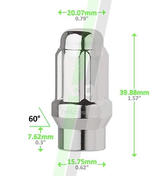

This one on amazon may be the ticket?
Amazon Amazon

I ordered the Amazon version. I will follow up as the Mini Steel wheels are about least expensive option going.

Our weather had been decent so I had not yet mounted the new snows yet. I checked out the lug nuts today to see how they meshed with the mini wheels and they don’t fit. The outside dimension of the lug nut thread extension will not pass through the bolt hole sadly.
I guess I need to find some without the extension part.

Just a quick update if anyone wants to run factory Mini Cooper steel wheels. I ended up with Mcgard lugs and locks. They are longer than need and look like nipples
They do however fit fine otherwise.
