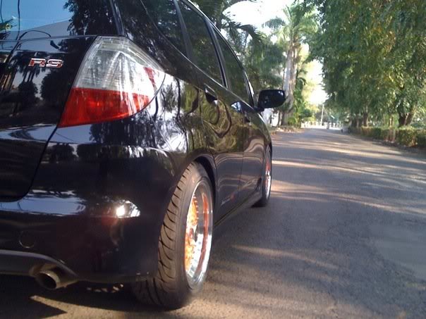

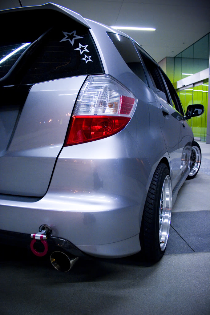

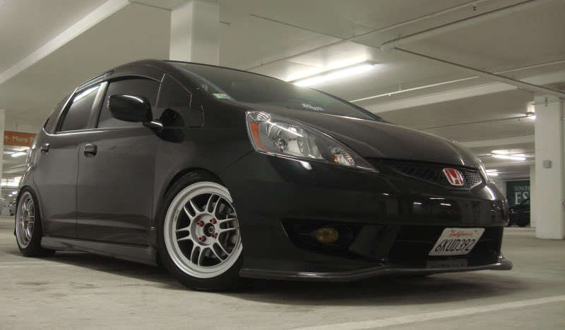

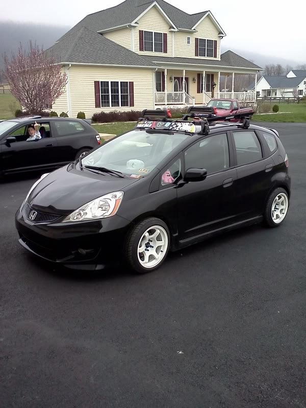

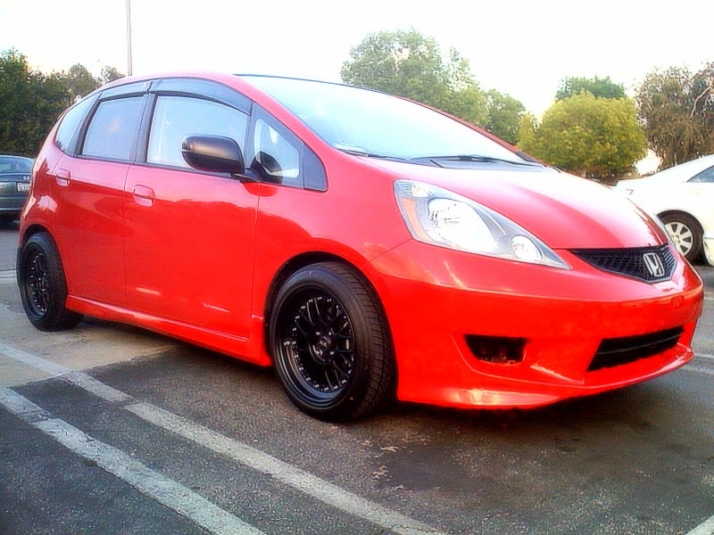

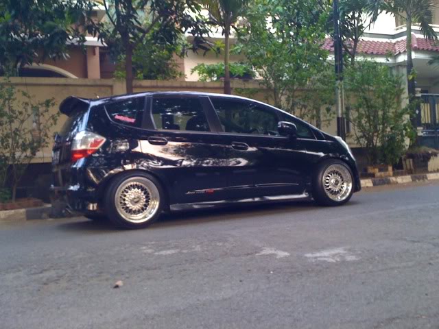

I can tell you FROM EXPERIENCE if you run an 8" wide wheel, an offset of 43 would be perfectly level with the edge of the front fender, and 8 et35 will ve perfectly level in the rear. To make a 16x8 et20 work, you are talking 205/40-16 tires, and probably a slight pull in the front. That is, if you want it to look decent.
Here are some GE8's running 16x8 (all found by going to Google and searching ge8 fit 16x8)
BBS RS 16x8 ET 27 16x9 ET 15
Rota Grid 16x8 et10 with 195/45-16 Falken Ziex ZE512
Enkei RPF01 16x8 35 with 205/45-16
Enkei rpf1 16x8 +38 with Dunlop Direzza Z1's 225/50/16
16x8 et20 XXR 521
16x8 et20 XXR 501
