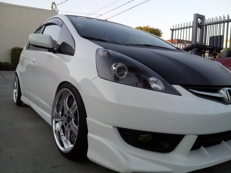

15x8 +25 is doable....
i roll on 18x8 +25 and 18x9 +35 just fine.. =)
Car is looking sick! 5 lug swap too man, crazy!
And not everybody is willing to camber and roll/pull fenders...
Weds Kranze Cerberus... so baller dude...
Old Jul 20, 2012 | 12:43 AM
ohanahuichubbz's Avatar
Posts: 327
From: alhambra, monterey park, CA
They're actually works euroline s2. Thanks though.
