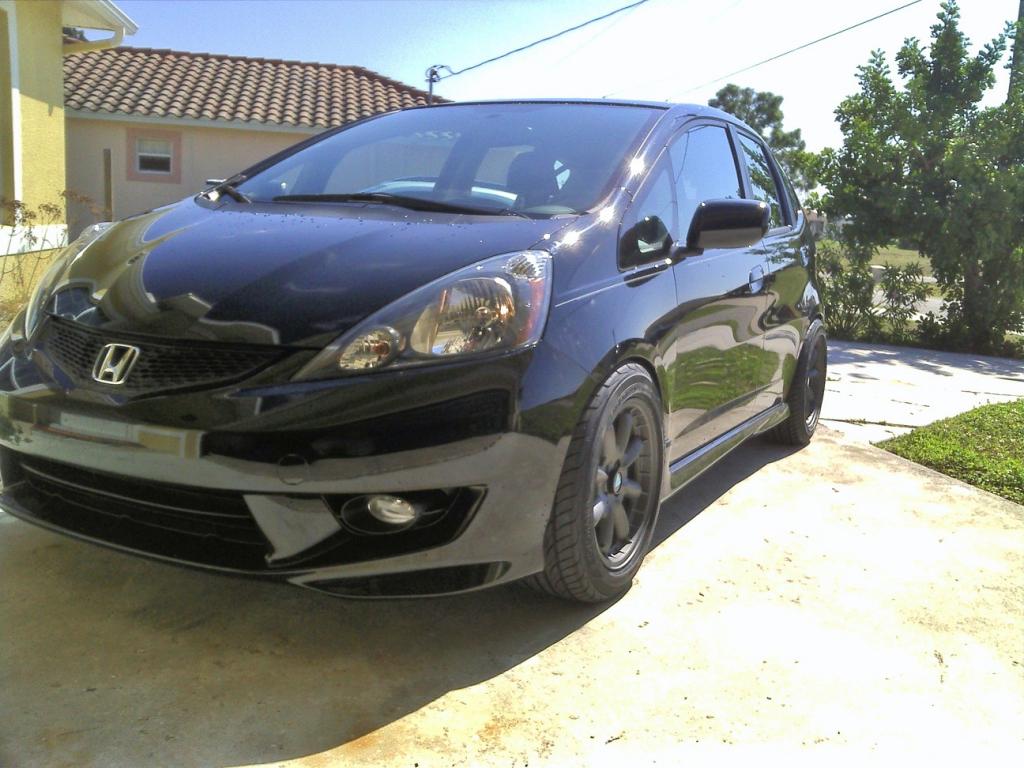

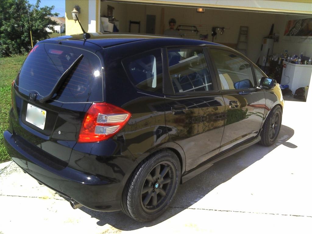

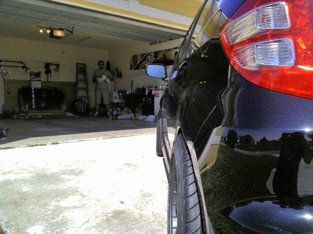

Mine with 16x8 +25 on 225/50's, lowered on B&G S2's. Fenders rolled and pulled front and rear, front fenders spaced out about 3/4 inch; cambered up front like -2 degrees or so (I think):

Rubs constantly. Had to remove the B&G's and put the stock springs back in. You probably won't be able to pull it off on springs, you'll more than likely need some nice stiff coilovers. Springs allow too much suspension travel. Also, stretched tires like others have said.
