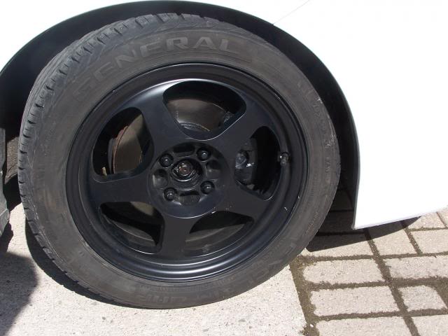

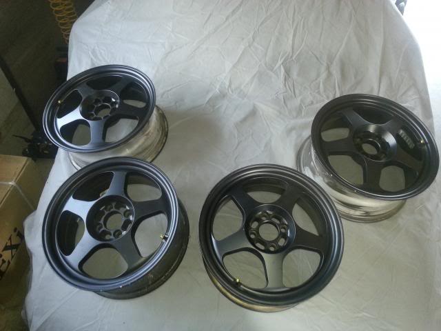

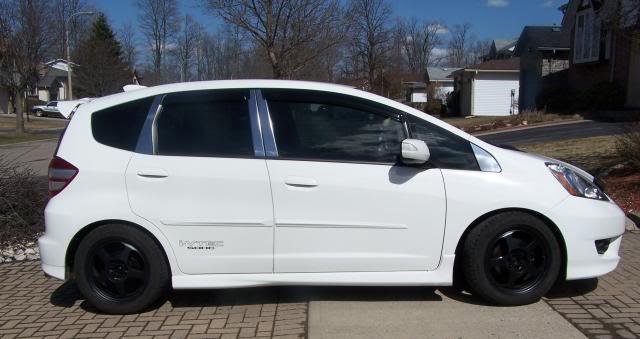

I just put these on. 16 x 7 General Exclaims UHP 205 50 16 . The offset is only 40 so I do get an odd rub on severe bumps. I am on Swifts as well. A nice solid feel.

Looks good and I love my Swifts too.I would like to get a nice set of wheels but the roads are so bad in my area that I just do not want to do it.
I would be so pissed if I bent a expensive new rim hitting a pot hole.I like your set up and those wheels look good on your TW Fit.
