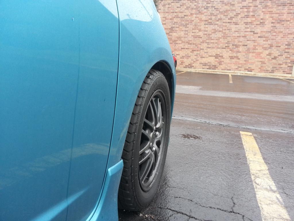

Its time for new tires and my buddy has a brand new set of 205/60/15's that he will sell me cheap.
im already rocking LS Meshies with 195/55/15 and it clears my fenders no problem, and im lowered on Tein S tech springs 1.6'' drop.
do you think I can clear 205/60/15's ?
*** LS meshies are 15x6 45 offset

On LS Mesh it should be fine. What is the offset and width on those? 15x6 +50 or something like that?
I rub on 205/55/15 with S.Techs on HARD turns, like full compression, so I had to tuck my fender liners back a little, but that's with 15x6.5 +40. You might be fine. If anything it won't be a big deal and definitely nothing that camber bolts wouldn't fix.
Meshies are 6'' wide and 45 for the offset

Here is the front on my 205/55/15 15x6.5 +40 with S.Techs
It's close, and since the springs aren't stiff, it rubbed a little on full compression, like I said, tucking fenderliners and pulling the tabs back fixed it, I didn't have to roll, pull, or even add camber bolts.
At the worst you might have to add bolts but they're cheap, like $35, but you'll have to get the car aligned if you add them, because it will also effect your toe when you add the camber because of the suspension design.
I am assuming in the pictures you have that is with 195/55.

yeAH I HAVE 195/55 . ILL PROLLY JUST GET 205/55 INSTEAD OF THE 60'S AND PLAY IT SAFE.
