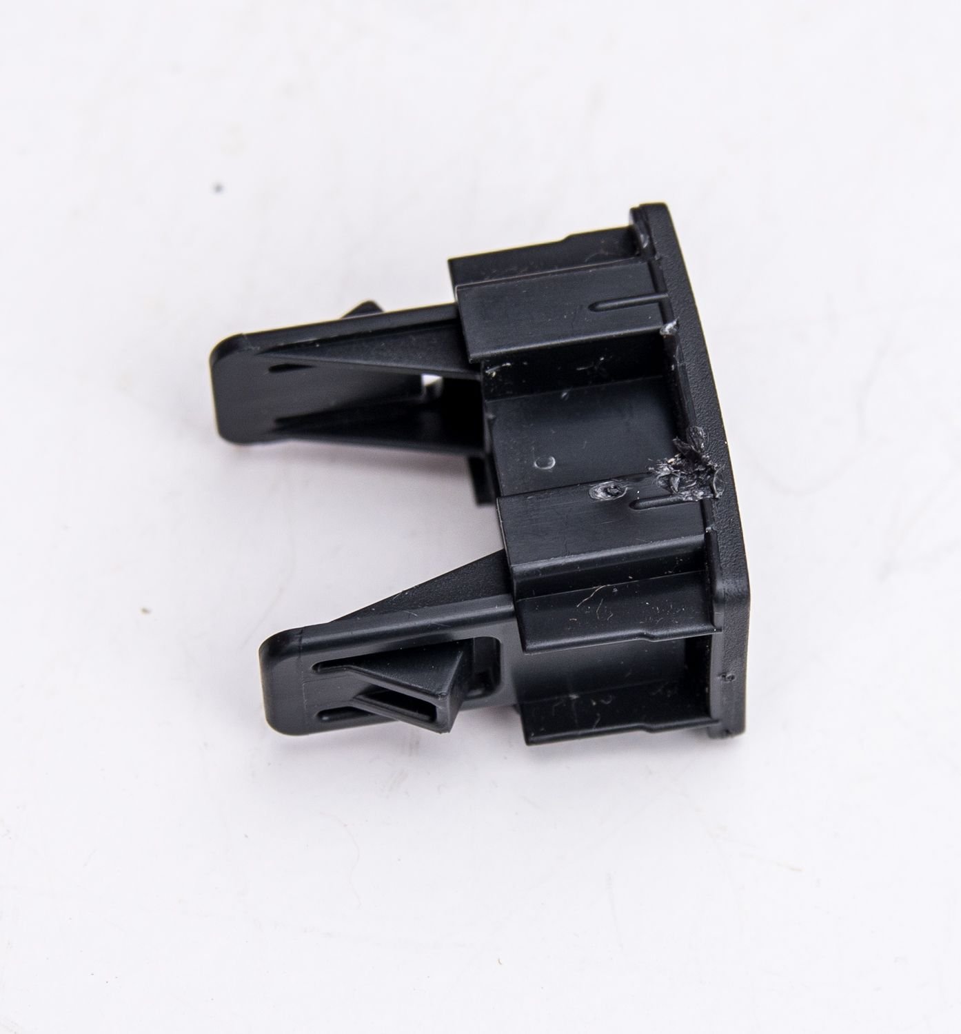

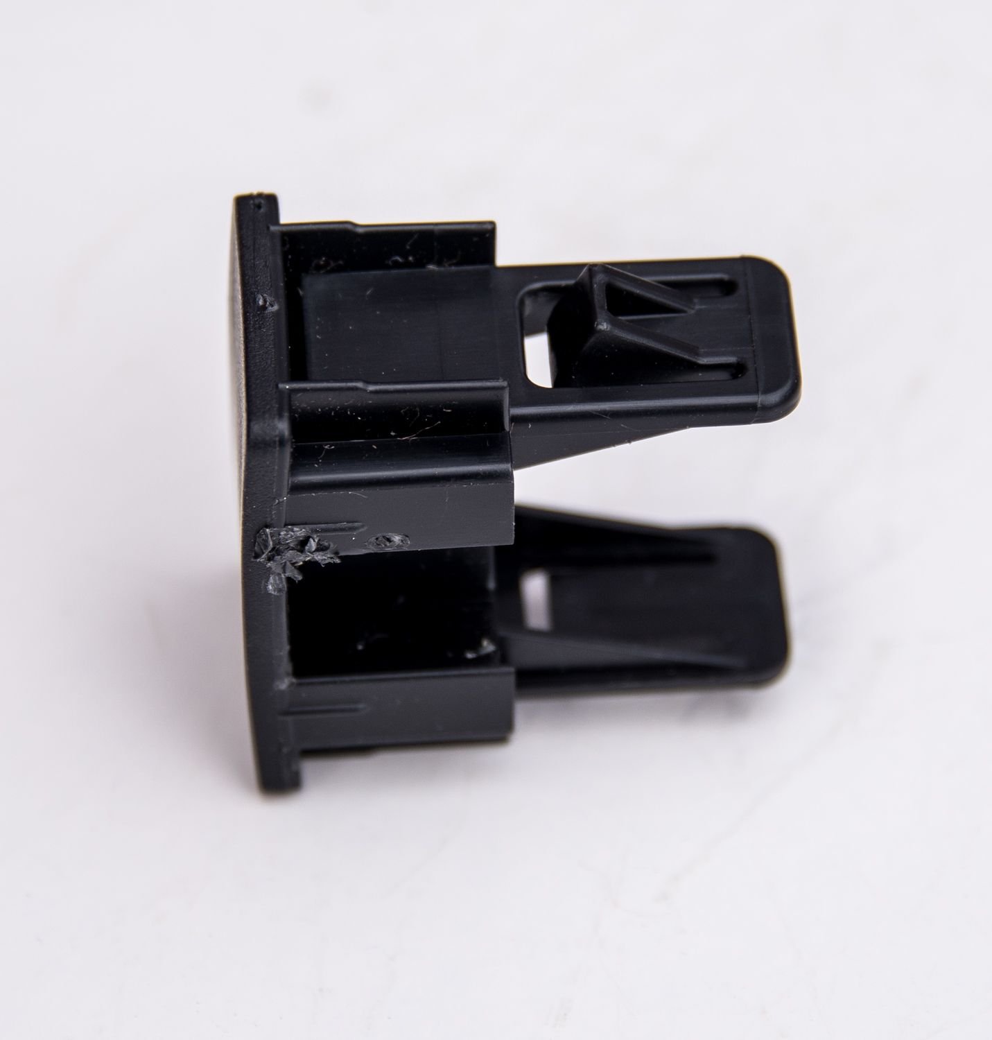

Switch Blank in 2019 EX
I did a post a week or so ago, asking how to remove the switch blanks to the left of the steering wheel on the dash. On my 2015, I easily pried them out. That didn't work on this 2019. Someone asked for a picture of the switch, so I have some below.
I removed the small cover from the side from the dash, next to the door. At the bottom of the opening is a 10mm/Phillips screw (use either tool). Remove that, and then you can remove the lower panel. I used a couple of plastic panel removal tools. I pulled it away just enough to get my hand behind the switch blank. It's help in place by two ears that grip the rear of the dash panel. It takes a lot of effort to squeeze those ears together (top and bottom) enough to push the blank out the front of the dash. I think you can get an idea what it looks like from the pictures below. I can't imagine why Honda made it so difficult to remove those two blanks.
