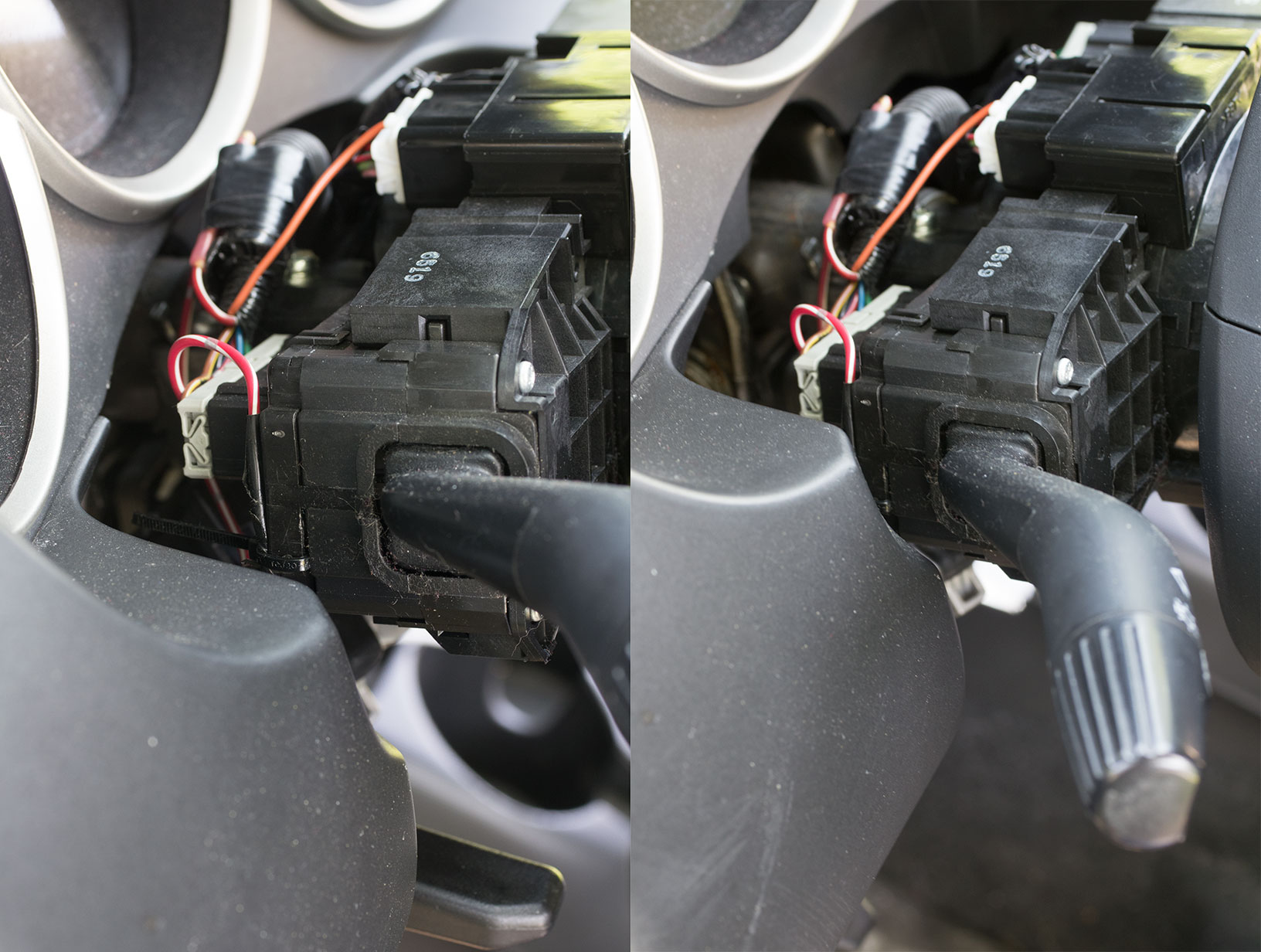

This weekend I looked into removing the wiper switch again, and I was able to remove it without pulling the steering wheel. I did this by removing the screws for the switch housing, which allowed enough play to just remove the switch. See my post here. However, I looked at the light switch side, and I am not sure this solution will work there. It looks like the dash contour on that side is bigger and the light switch itself is bigger than the wiper switch. Maybe you can try it yourself, but it doesn't look promising .
Shown with the steering column in the all the way up and down positions:

My experience confirms your suspicions about removing the light switch -- no way I could get it to clear the dash contour -- even after removing the housing screws and jostling it -- unless there is some way to further twist or remove that collar.
