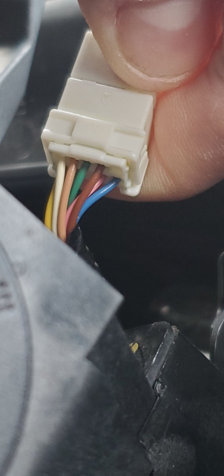

Adjustable speed wiper stalk upgrade? 3rd GEN
So, i have good news. A variable speed wiper stalk from a 2016 CRV is plug and play with the 3rd gen, bad news is i have no idea where to extend an extra wiring/pin to for the variable speed setting to work Between the two, the stalk the CRV has there is a wire unning from one spot to another inside? Has anyone done this mod completely? Do I just swap those wires or add a pin? I'll post some pics i got
