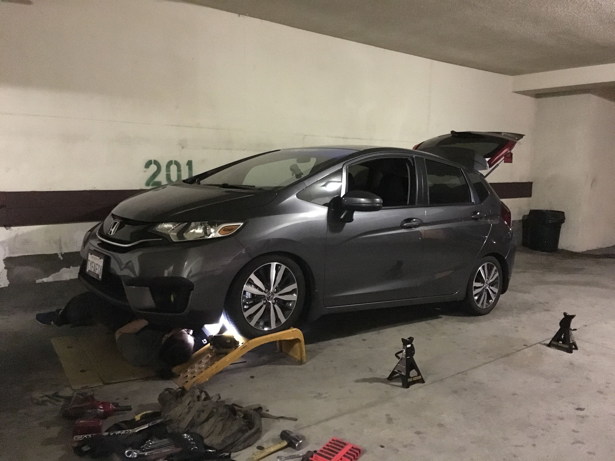

Originally Posted by Spyke
Pre-loading is important, idk why people skip that.
A fellow GK5 owner, at a car meet, reported his rear sway bar making noises and I asked if he had completely tightened the hardware while the car was up in the air to which he replied yes. He redid the bolts with the bar preloaded and reported no more noise.
Originally Posted by galaxy convoy
Instruction didn't say it needs to be pre loaded when torquing things down. Anyways i tried torquing things down when its on the lift and on the ground didn't change anything
General rule of thumb/good practice for suspension is to hand-tighten the hardware, preload the suspension, and then torque to spec. A friend and I were lazy while installing the coilovers on my GK and my front sway bar was binding because we tightened the bolts while the car was sitting like this:
I had to drive the car up on some ramps to mimic the suspension being loaded up and we loosened and retightened the bolts as depicted below:

what's the hammer for ?
Old Sep 6, 2019 | 03:05 PM
USDM's Avatar
Joined: May 2017
Posts: 1,207
From: Southern California
It was just in my friend's bag.
