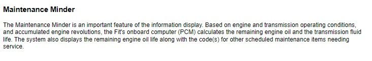

It's actually calculated according to operating conditions and accumulated engine revs. We have uber and taxi drivers come in for oil changes every like 1-2 months

I don't think anything in the MM is based on time because otherwise the MM would call for an oil change at one year regardless of anything else. But no, the manual says that if you haven't gotten a notice to change the oil, do it when it's been a year since the previous oil change (which happened to me during early pandemic when I wasn't driving much.
FYI My first CVT fluid change notice from the MM came on recently, at around 52,000 miles. It was easier to do than I thought, so I'd do it again in another 30,000 (because you don't get most of the fluid out when you change it), but I probably won't own the car by then.
