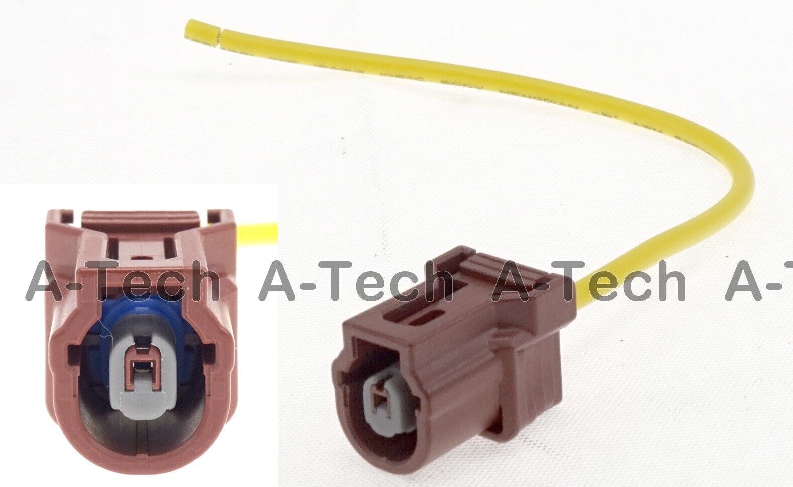

I am happy it worked out for you. It seems to be a common problem. If the problem ever returns I might try replacing the connector. I found a part on Ebay.
https://www.ebay.com/itm/13419583192...mis&media=COPY
